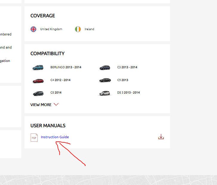

For the official guide on installing, use this link (https://citroen.navigation.com/product/ ... enEMEA/GBP) and look for the download guide PDF I have arrowed in Red:
