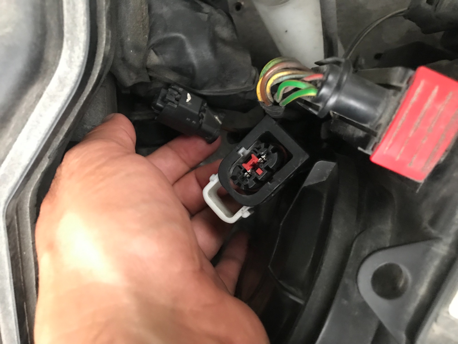

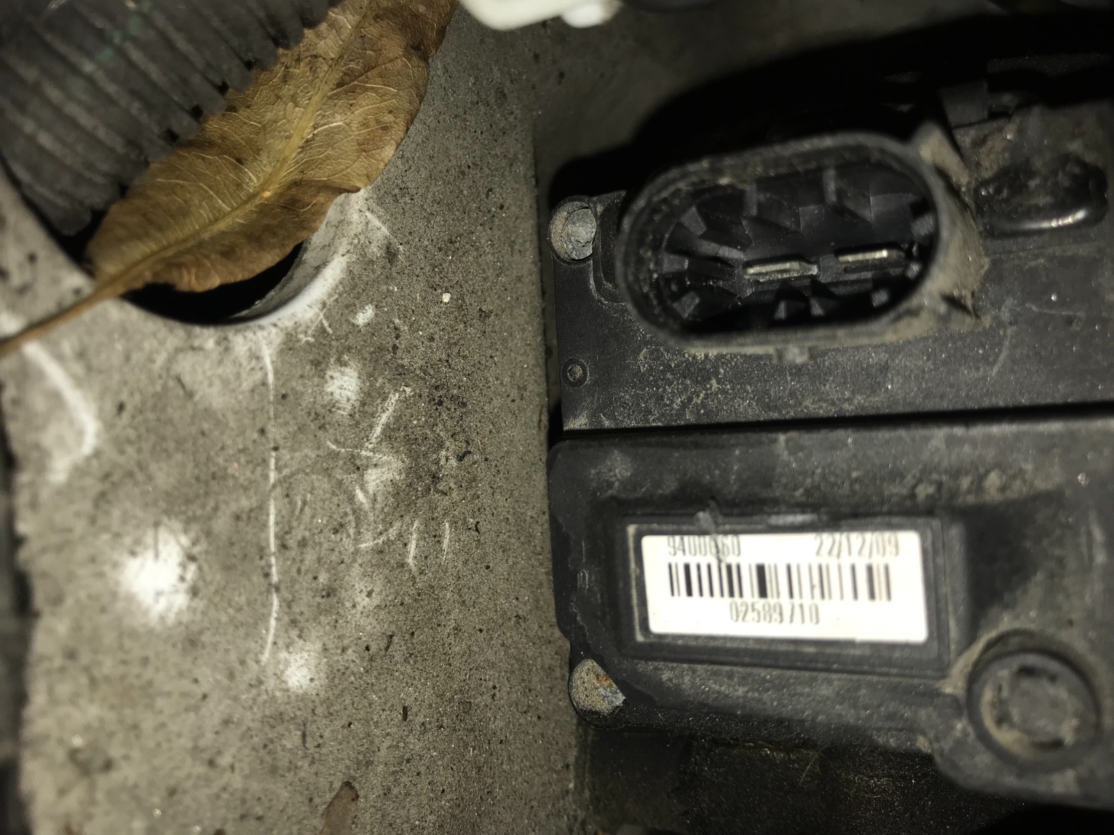

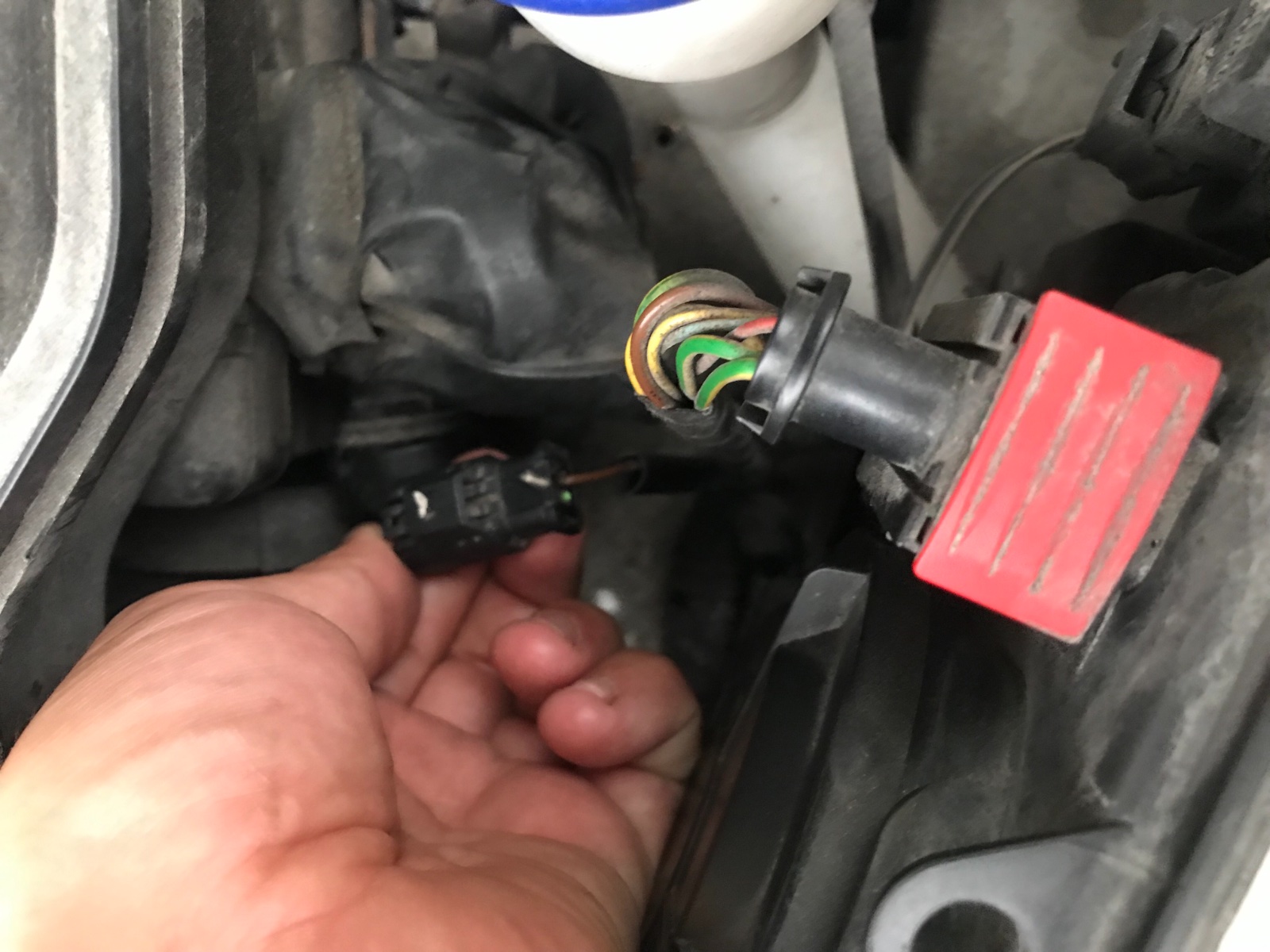

here are the cables i messarue.

Ezmir, from your last pix beside the main 2 pin plug that powers the motor, on the right is a pin thats enable the motor.I can,t remember but likely it needs 12v to enable the motor power. You can power up the motor directly this way independent of the computer control by supplying 12v to the main connector and a 12v to the pin on the right
I got a feeling your BSI part which control the power to pump motor is faulty, I never open it up before so I can,t help.
