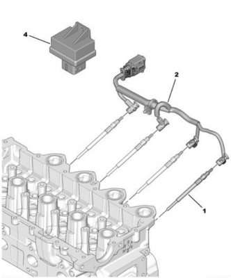

As per parts info, but be aware almost every HDi engine I have dealt with has a glow plug error - but these shouldn't prevent it starting unless they are all shot and in freezing temperatures.
Hera are the parts you wanted:
Beru plugs (1), Part: 5960F9, £24.91 from Citroen inc. VAT
Glow Plug Relay (4), Part: 598140, £74.21 inc. VAT
Re: Diagnostic - Picasso Xsara
Check & replace glow plugs before anything else
