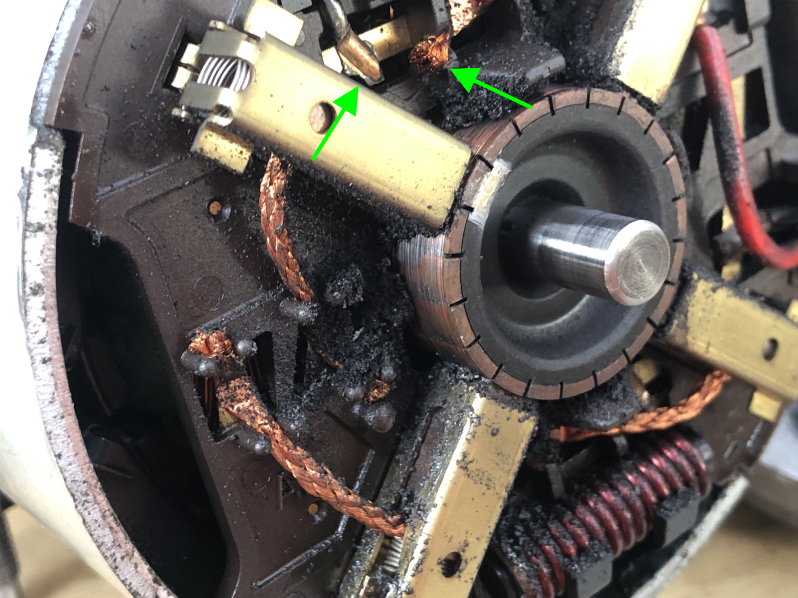

Managed to get BHI unit out yesterday and sure enough a fair bit of LDS and carbon paste build up inside. I forgot to size the high pressure blue o-rings, do you happen to have a spec for these (size/material) ?

And it looks like one of the wires has sheared off where I have highlighted it in green... so that will be why the pump isn't working....
