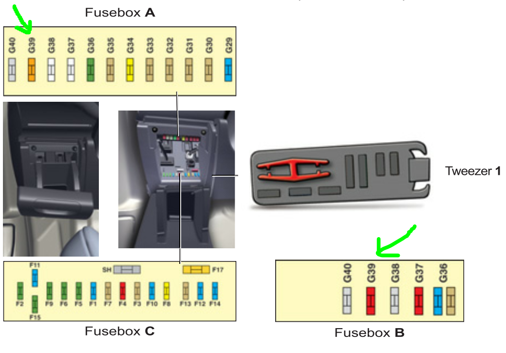

Fuse G39 is in the BFH1 fusebox where the BSI is in the passenger glovebox (but be aware there are 2 sets of 'G' fuses!) You need the bank G36-G40. It may be tucked to the
side somewhere attached to the BSI. Also be aware that some X7 Owner's Manuals had the incorrect fuse information, typically showing Fuse Box 'A', 2 Fuse Box Bs and NO fuse box 'C'. I've arrowed in green the 2 G39 fuses, you need the one in Fusebox B which is a 10Amp for the Suspension.
There is also Fuse F13 in the BSI (Hydraulic suspension pump cut-off relay)
Maxi Fuse MF7 is for the active suspension with variable damping (may be there for operation of the system, but without active damping)
Maxi Fuse MF3 is for the Power Steering

4) Yes G39 is the main fuse for the Hydraulic suspension / Pump
Power Steering Diagram
5) The relay is located near the suspension BHI - the only diagram I have is here:
If the pump isn't running, change the fuse G39 - and see if you can get the pump running enough to get it off the ground. Once up and pressurised, the motor only really runs occasionally to maintain pressure - the pump does not run all the time unlike older days of the CX Hydropneumatic systems.
