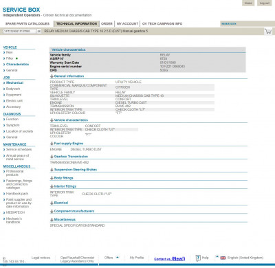

Re: How can I find out what I have here?
This is the totality of factory spec info, very brief - maybe because a Utility Vehicle (Relay).
No further info under most of the headings.
Hope helpful, anyway.

Above and beyond guys! I will make a donation as it has lowered my stress levels somewhat. I just need to find it's original weight now. Perhaps it was 3500kg as it is 'a medium chassis'. I wonder how svtech have built this body heavier but it still has 3500kg on the sticker? I have some investigating to do. :D
