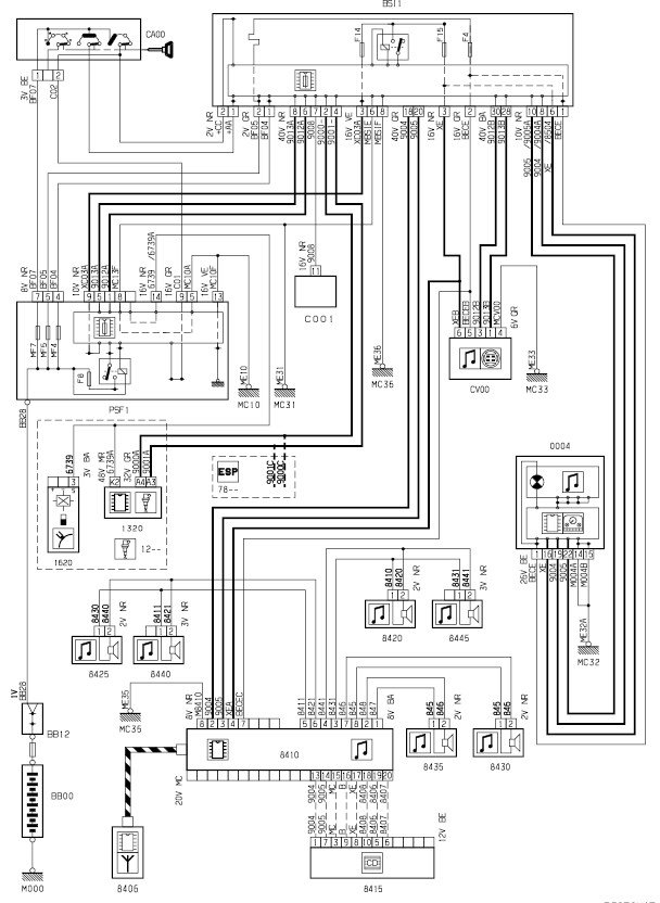

thanks lads heres more info this is what i did
1 followed battery disconnect procedure
2 removed factory h/u (vdo rd3)
3 cut white loom plug off car and connected to my aftermarket head units speaker wires
4 cut black loom plug off car connected as follows
car........................................... new h/u
a7 thick pink ........................... yellow and red (12v sw and perm live)
a8 green/yellow........................black (ground)
a5/6 not present on my car
a4 purple..................................black steering wheel neg THIS CONNECTION WAS WRONG AND BLEW FUSE 15 (15A) thanks to wheeler
a3 two white ............................brown steering wheel line 1
a2 two red..................................brown steering wheel line2
a1 not present
5 battery reconnect procedure
test new head unit with 7" slide out touch screen.......working nice.. steering wheel controls work
start car...cranks but wont fire .....no hazards... no dash display no remote locking
removed radio and did bsi procedure again no change
this is the radio pinout i used

Oh dear
First off pin 4 on the original radio is a VAN+ supply & you have connected this to 'steering wheel neg'
Connecting a live supply to a negative wont end well.
Looking at the diagram I'll bet anything you have blown fuse 15 in the BSI behind the dash RH side, hopefully thats the only damage. Check fuse 4 if 15 is ok.

just got back with some mini and maxi fuses going out now to check 15 and 4.....when you say 15 is in bsi do you mean not in cabin fusebox but in the actual comms unit ?
thanks alot fella "fod slap emoji indeed."
WHEEELEERRRRRRR YOU DA MAN. fuse 15 in cabin fusebox was popped good..swapped for new 15a fuse..hey presto dash display locking all working
