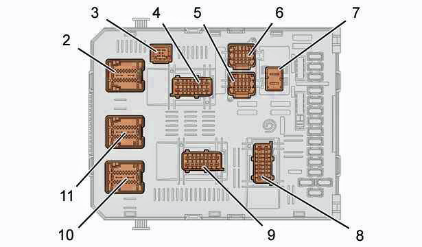

I pulled connectors and removed it as I was trying to trace faults. The plugs are in their right place as I took a photo before reassembly. I've removed it again today to see if I can see any spare sockets but I feel that the plug that is there is redundant and just part of a standard loom.

Here is a diagram of your BSI and the fuses. I can't help with the relays as these are integral, but it may also be worth checking the supply to the BSI - Engine Fusebox and also the supplies control unit.
This first is the diagram for the connectors on the BSI and the table below the Key, followed by the BSI Fuses in the second diagram.
Reference | Connector | Number of channels | colour | Designation |
2 | EP | 40 | Black | Main harness electronics |
3 | EA | 6 | Black | Accessory electronics |
4 | PP | 16 | Green | Main harness power |
5 | PB | 10 | Black | Dashboard harness power |
6 | PB1 | 10 | White | Dashboard harness power |
7 | AP | 2 | Grey | Main harness power supply |
8 | PH2 | 16 | Grey | Power to the passenger compartment harness |
9 | PH1 | 16 | Black | Passenger compartment harness power |
10 | EH2 | 40 | Blue | Passenger compartment harness electronics |
11 | EH1 | 40 | White | Passenger compartment harness electronics |
F1 | 15A | Battery + | Rear Screen Wiper Motor |
F2 | 30A | Earth | Locking - Unlocking |
F3 | 5A | +APC | Airbags And Pretensioners Unit Supply |
F4 | 10A | +APC | Fuel Additive Pump - Photochromic Interior Rear View Mirror - Suspension Control Unit - Driver´S Aircon Control Panel - Multimedia Assembly |
F5 | 30A | Battery + | Driver´S Window Control Unit - Passenger´S Window Control Unit - Electric Blind Motor |
F6 | 30A | Battery + | Rear LH Window Control Unit - Rear RH Window Control Unit |
F7 | 5A | +ACC | Refrigerated Central Storage Lighting - Glove Box Lamp Switch - Audio System |
F8 | 20A | Battery + | Switch Module At The Steering Wheel - Radiotelephone Transceiver - Deflation Detection ECU - Multimedia Assembly - Antitheft Alarm Volumetric Unit - Alarm Siren |
F9 | 30A | +ACC | Movable Boot Lighting - Front Cigar Lighter - Multimedia Assembly |
F10 | 15A | Battery + | Suspension Control Unit |
F11 | 15A | Battery + | Ignition Switch - Brake Dual-Function Switch |
F12 | 15A | Battery + | Rain/Sunlight Sensor - Passenger´S Seat Adjustment Relay - Parking Assistance ECU - Lateral Trajectory Monitoring ECU - Radio Amplifier |
F13 | 5A | Battery + | Fusebox Relay Unit PSF1 Supply - Seat Memorisation Control Unit |
F14 | 15A | Battery + | Control Panel - Air Conditioning ECU |
F15 | 30A | Battery + | Driver´S Door Lock Assembly - Passenger´S Door Lock Assembly - Rear Left-Hand Door Lock Assembly - Rear Right-Hand Door Lock Assembly |
F16 | Shunt | Shunt | Park Mode / Customer Mode |
F17 | 40A | Battery + | Heated Rear Screen |
