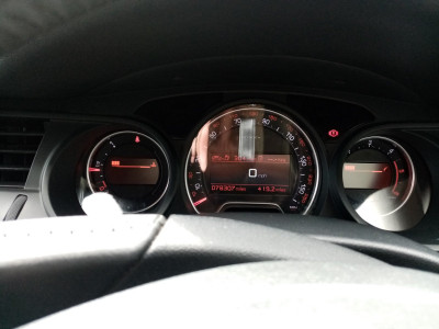

Update
Hi all
Just an update regarding retro fitting an upgraded instrument cluster.
First of all it was not as easy as I first thought because you have to remove the top and bottom steering column trims x2 torq screws then remove the screws securing the cluster in the dash board x4 torq screws
The cluster has one electrical connection that you can just about get to without removing the cluster trim
You then have to remove the comms unit because there's not enough room to remove the cluster from behind the steering wheel
Four torq screws secure the cluster to the trim and access is tight, the cluster then comes away from the trim.
Please see photographs of finished installation (well apart from cleaning) I just need to connect to lexia and check settings
A question for Marc if he would be so kind
What settings will get me the maximum information on the cluster
I hope this helps someone else in the future
Note
Confirmation that no Vin appears to be stored on cluster and no errors on Lexia
Kind regards
Steve

- GiveMeABreak
- Posts: 37433
- Location: West Wales
C5 MK I 2.0 HDi SX Wicked Red
C15 Romahome White
XM 2.0 SX Polar White
CX 20 Polar White
GS 1220 Geranium Red
Re: Instrument cluster
The settings are not optional Steve, they are based on specific equipment fitted to your car, so with the MyWay upgrade you have done these are the settings for you specifically:
Parking Assistance Option: Masked
Current Information Display Position: Trip Computer
"Stop & Start" Option: Function Masked
Maintenance Indicator: Function Displayed
Oil Gauge Option: Function Displayed
Controlled Suspension Option: Function Masked
Navigation Option: Function Displayed (as I think your upgraded to MyWay Navigation)
Cruise Control Option: Function Displayed
Trip Computer Option: Function Displayed
Volume and Distance units: Litres/100km
Cheers Marc
I think the settings are the same
Thank you for your assistance
Regards
Steve
Regards
Steve
