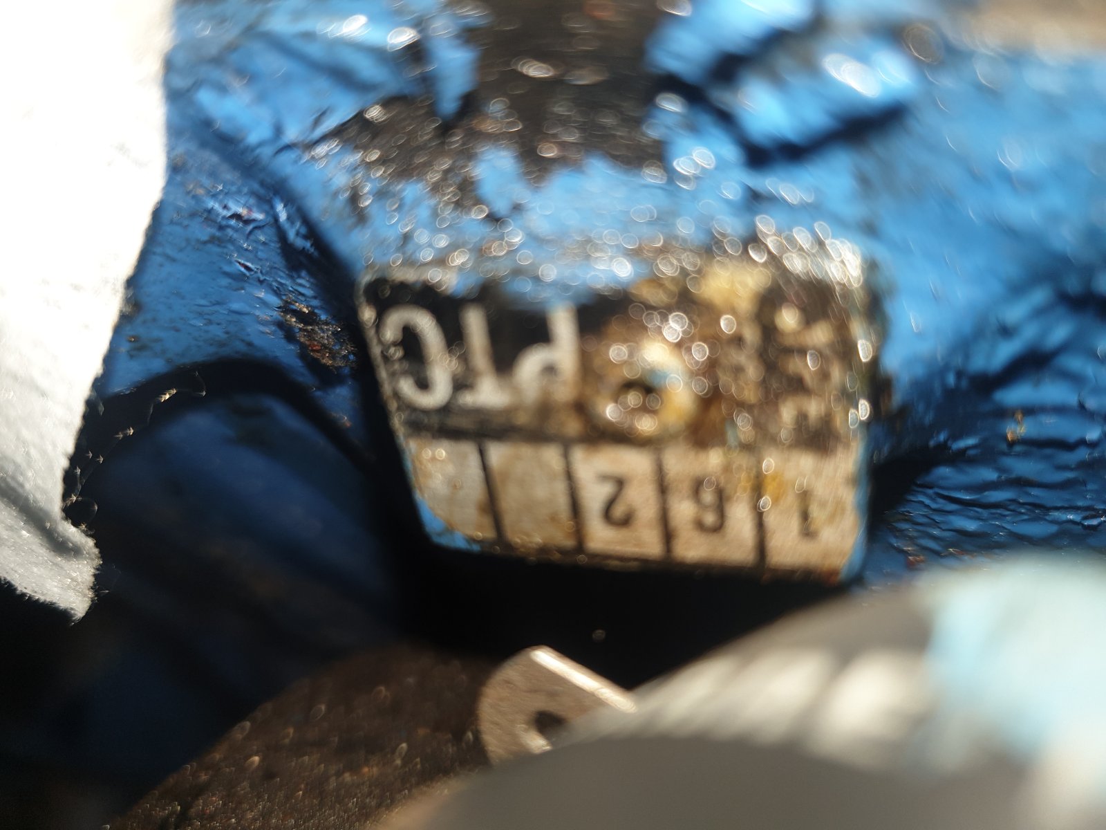

Hi all I am hoping someone on here may be able to help me. I've just bought a narrowboat with a peugeot engine. Block tag say PTC Type 162. Cylinder head has 4.7kw stamped by the thermostat housing which is all metal.
I need a new cylinder head after the cambelt snapped and basically it's now no good and cannot be repaired. I belived the engine was a 1.8d. But now believe it's a 1.9d as the bore size is 84mm.

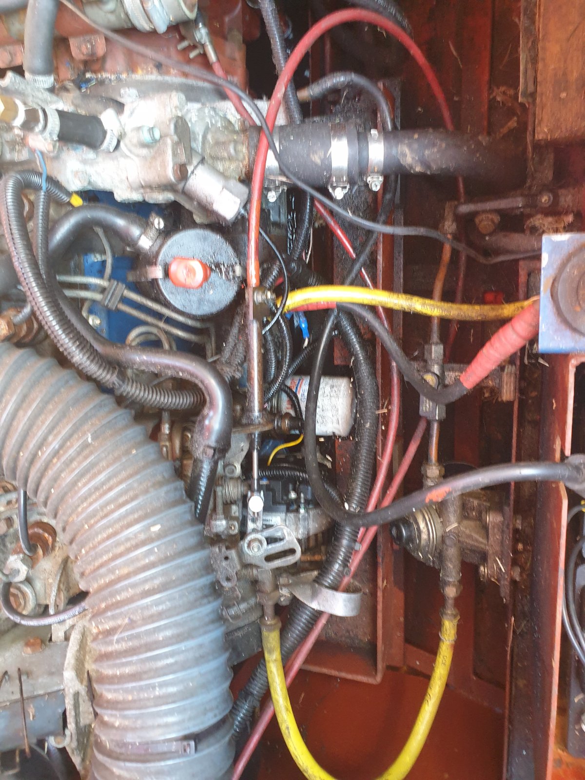

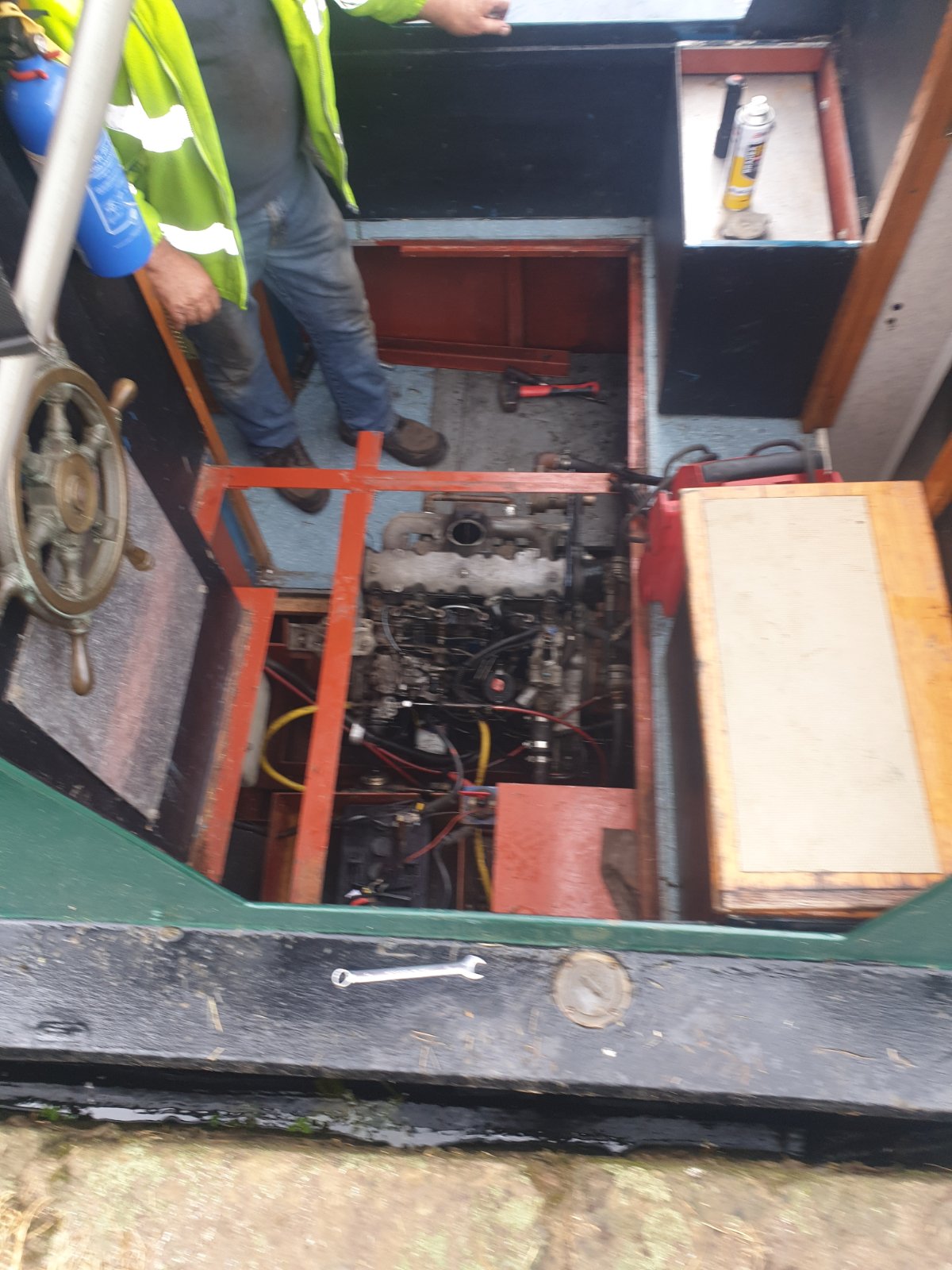

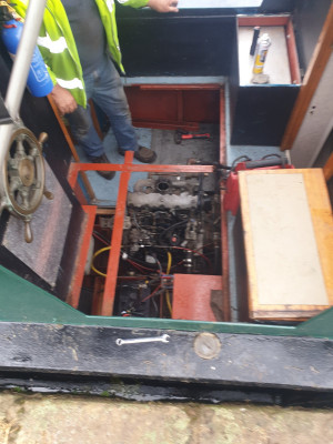

Please find pics attached off the engine fitted.
Thanks John

The block label 162 identifies it as an XUD9 (1.9) engine.
161A = XUD7 (1.7/1.8).
So the same as our blue smurf project above.
Haynes' manual #1379 (Diesel Engine) covers this engine really well.
