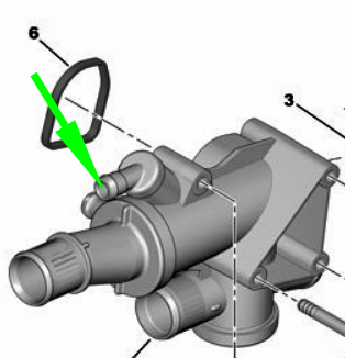

However, I can still only find one bleeding point, the one on on the thermostat housing. The second bleeding screw should be on the heater hose close to the bulkhead but I cant find it. Is it located elsewhere?
- x 6957
Re: Coolant bleeding points and procedure DW10 2010
The bleed screw is shown in blue below and I have marked this with the green arrow in the bottom picture - but the outlet tank may well be reversed from the picture.

According to your excellent guide (Draining, Filling & Degassing) on the x7 there should be 2 bleed screws. I have found screw Nr 3 on the thermostat housing but are unable to find bleeding screw Nr 1 on the heating hose. Is it possible that my car have only one bleeding screw?
- Posts: 6847
- x 3567
Bleed screw number 1 is right over the back of the engine. If you can wait until later today, I'll put up a picture of it from my car.
