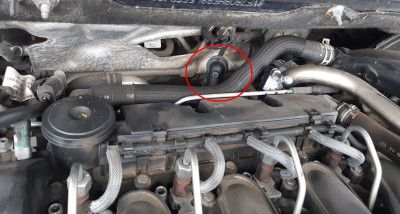

According to your excellent guide (Draining, Filling & Degassing) on the x7 there should be 2 bleed screws. I have found screw Nr 3 on the thermostat housing but are unable to find bleeding screw Nr 1 on the heating hose. Is it possible that my car have only one bleeding screw?

Re: Coolant bleeding points and procedure DW10 2010
Bleed screw number 1 is right over the back of the engine. If you can wait until later today, I'll put up a picture of it from my car.
Ok! So its located on the heating hose only closer to the engine and not the fire wall.
A pic would be super. No rush.
Thank you!
With the engine cover removed.....
Found it! Thank you!
