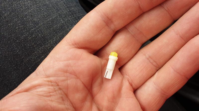

This morning, I went looking for a replacement bulb, but I couldn't find a shop near me that sold this type (I think they're 1.2W bulbs, but I found various designations for it). I went to a nearby Chinese shop and found that T5 LED bulbs are supposedly the same thing, and bought a new fancy LED bulb. I didn't get to photograph it because as soon as I got to the car, I promptly lost it down this hole:
Then I had to buy another one, and the only type left was this cheap one:
I was happy to have remembered to test the bulb before reassembling everything again.
For those that don't know, LEDs have polarity and if, in this case, you put it in the wrong way you'll want to shoot yourself for having to disassemble everything again.

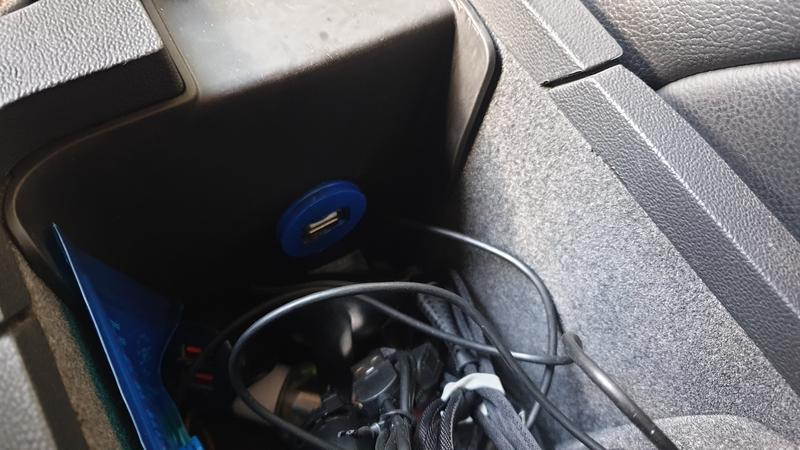

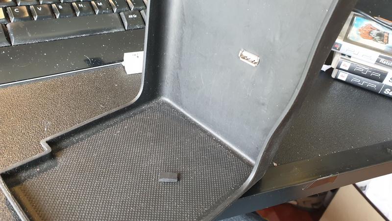

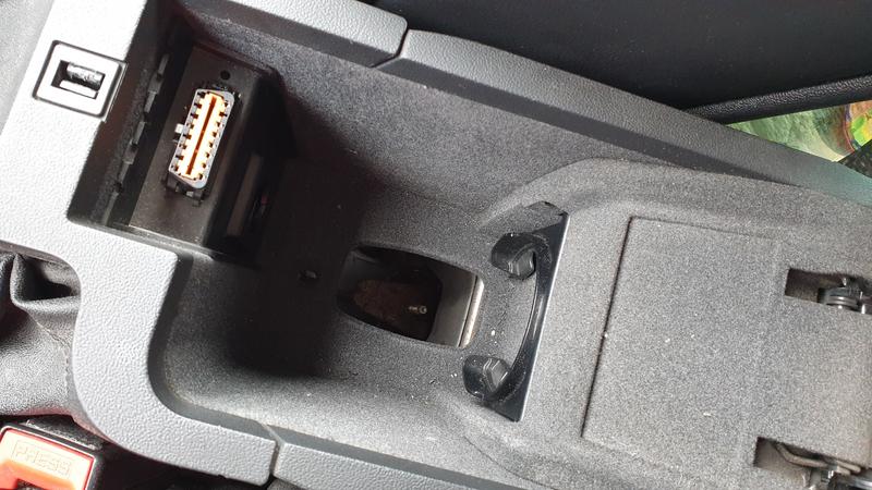

Second thing was to run a USB cable down the middle. One day,my RD45 will finally arrive and I can install it and the missus can plug in USB sticks and she'll be a happy bunny, but I have been having lots of different ideas as to where to put the port. First it was in the tray beneath the radio, then the "secret" cubby that doubles as the fuse box cover on LHD models, to the left of the driver's knee. Then finally I decided to put it where most C5 X7s have their port: in the armrest cubby. I had to cut out a little rectangle of rubber in the cover, and I don't think it ended up looking too shabby:
Problem is, shove in a pen-drive with a modicum of force and that USB socket slides straight out. This socket that's poking through the armrest cubby lining is part of an extension cable that I thought would be necessary, but it wasn't the case, so I just used the RD45 specific cable and made a hole for it. To stop it slipping out, I used some hot glue:
It looks crap, I know, but it wont be visible. The other side that will be visible, looks terrible:
That's a blue plastic bottle-top with a rectangle haphazardly cut into it and it's all kept together with hot glue. It looks dreadful but I was tired and out of patience by this point. Besides, I'm looking for a cover with a hole for a USB socket to replace this eventually. I kept the rubber bits I cut out and I can replace them, even though it'll look Frankenstein-y.

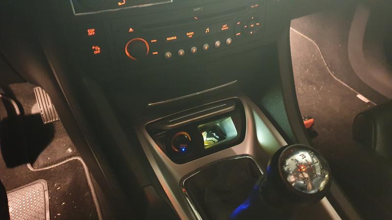

In other news, this is what an LED-illuminated ashtray looks like:
I think that's waaaay too bright, so I'll remedy this by using one of my children's yellow felt-tips to paint the actual bulb.

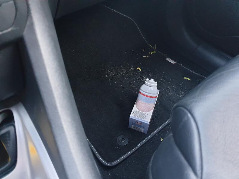

Another problem I had in the car was smelly AC. I had long sought a solution for this issue without having to take it to a sodding mechanic (I've been through about seven different mechanics in the last 3 or so years, I keep changing because the suck so much). I first tried some off-brand, 3.50€ disinfectant spray you leave in your footwell while the AC is blasting. I tried it twice and it didn't work. Then I got some Liqui-Moly Klima Fresh and tried that.
Just like the off-brand stuff, you leave it in the footwell but this product told me to switch off the AC, crank up the temp to the max and then crack open the spray in the footwell. Problem was, the stupid instructions didn't bother to specify what setting the AC should be on during the spray process so I left it in full-furnace mode.
So far, it seems to have worked, but I won't count my chickens yet because there still seems to be a funky smell coming from the vents when I turn the AC off.

That won't do it alone. You really need to whip the pollen filter out and be prepared to hoover out a load of dead bugs and such. They get trapped in there and start to rot, along with all the trapped debris from the outside, leaves and other rubbish and this can leave a bad smell over time.
Ideally, a pollen filter change, hoover out of the filter area with a suitable bendy crevice tool, then use your Air Con Bomb, then fit the new filter back.

Allegedly, when the pollen filter is out and the bugs vacuumed out, spraying with Dettol spray onto the aircon gubbins is effective, cheap and easy.
Not standard Dettol but the spray.
This sort of thing. There are several.
