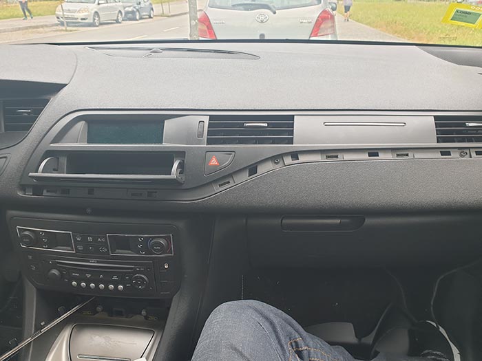

Here is the radio with the display sitting atop it waiting for installation:
Now, I have to admit I completely forgot to take pictures, so my sincerest apologies. My youngest was frolicking in the back seats because I had nowhere to leave her, so it was rather distracting and taking photos just slipped my mind. Having said that, it was such a doddle that it hardly seems worth the fuss of illustrating it. It was just a question of removing the old RD4 then placing the new radio in its place, plugging in all that needed to be attached, and hey presto, it was ready to go. The USB cable was already in place, a process which I described on another thread instead of here (viewtopic.php?p=647931#p647931), because I'm an idiot.
The centre display was replaced, but again, so easy as to dispense illustration. It was just a matter of undoing two screws, one on either side, swwapping the dispays, redo screws, and job's a good 'un.
But it works like a dream:
