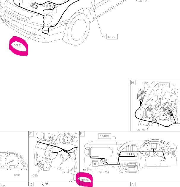

Below is a diagram for a Saxo but should be very similar. It shows the route of the IND wire from the alternator, I would have a look at interconnectors IC02A & IC20A.
Especially IC02A id be pulling that apart to check for water ingress/corrosion.

Hi quick up date had a look after tea. cleaned the IC02 and the connector and the two earths next to them they looked mint inside.
Had it running a little while as I lent in to turn the car off I caught the wipers and it brought the battery light on. I turn the car off and on again to try and make this happen again but it didn’t
