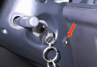

Also is there a small square button on the steering column cowling. If so hold the button in while turning on the ignition, the four ways should flash.

Ive read in some forum about the square Button but couldnt find one on this car :(. (dont have the old keypad Immo either)

"Four ways" I assume means the orange direction indicator arrows, which is what happens on my 2.0 XSi if the battery is reconnected and the doors are not previously locked with the fob. I then have to press the square button on the right side of the steering column with the key in the ignition and set to accessories mode or something. You then press the fob to lock and unlock the doors and that stops the alarm and the flashing orange lights. However if you already have the doors locked with the fob, and then reconnect the battery the alarm does not go off and no flashing lights on the dash etc.

On right hand drive UK models this is the button. " 4 ways " is a term we use for the hazard lights, the four indicators flashing.

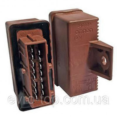

I assume that the car was starting and running OK before it was put into storage. If its not the immobiliser it could be poor connections caused by corrosion due to lack of use. All you can do is clean all the earths, check all the multi plugs for "green" corroded connections. Also relays can stick or get hot. Check the small green one in the interior fuse box. Then there is a multi function fuel pump relay in the engine bay fuse box. Its like this one in the image.
I`ve had a few 306`s and 406`s that suddenly wont start, change this relay and they fire up again. There are many different types, so you must have the exact replcement.

I went out and took another look, no square button :(.

Multifunction relay is working, took it apart earlier this weak. The ecu is supposed to send earth to the multifunction relay but doesnt. If I put earth to the relay the fuel pump works.
