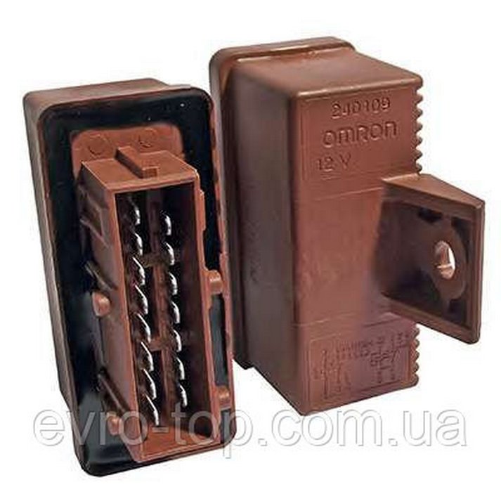

I assume that the car was starting and running OK before it was put into storage. If its not the immobiliser it could be poor connections caused by corrosion due to lack of use. All you can do is clean all the earths, check all the multi plugs for "green" corroded connections. Also relays can stick or get hot. Check the small green one in the interior fuse box. Then there is a multi function fuel pump relay in the engine bay fuse box. Its like this one in the image. I`ve had a few 306`s and 406`s that suddenly wont start, change this relay and they fire up again. There are many different types, so you must have the exact replcement.

Multifunction relay is working, took it apart earlier this weak. The ecu is supposed to send earth to the multifunction relay but doesnt. If I put earth to the relay the fuel pump works.
