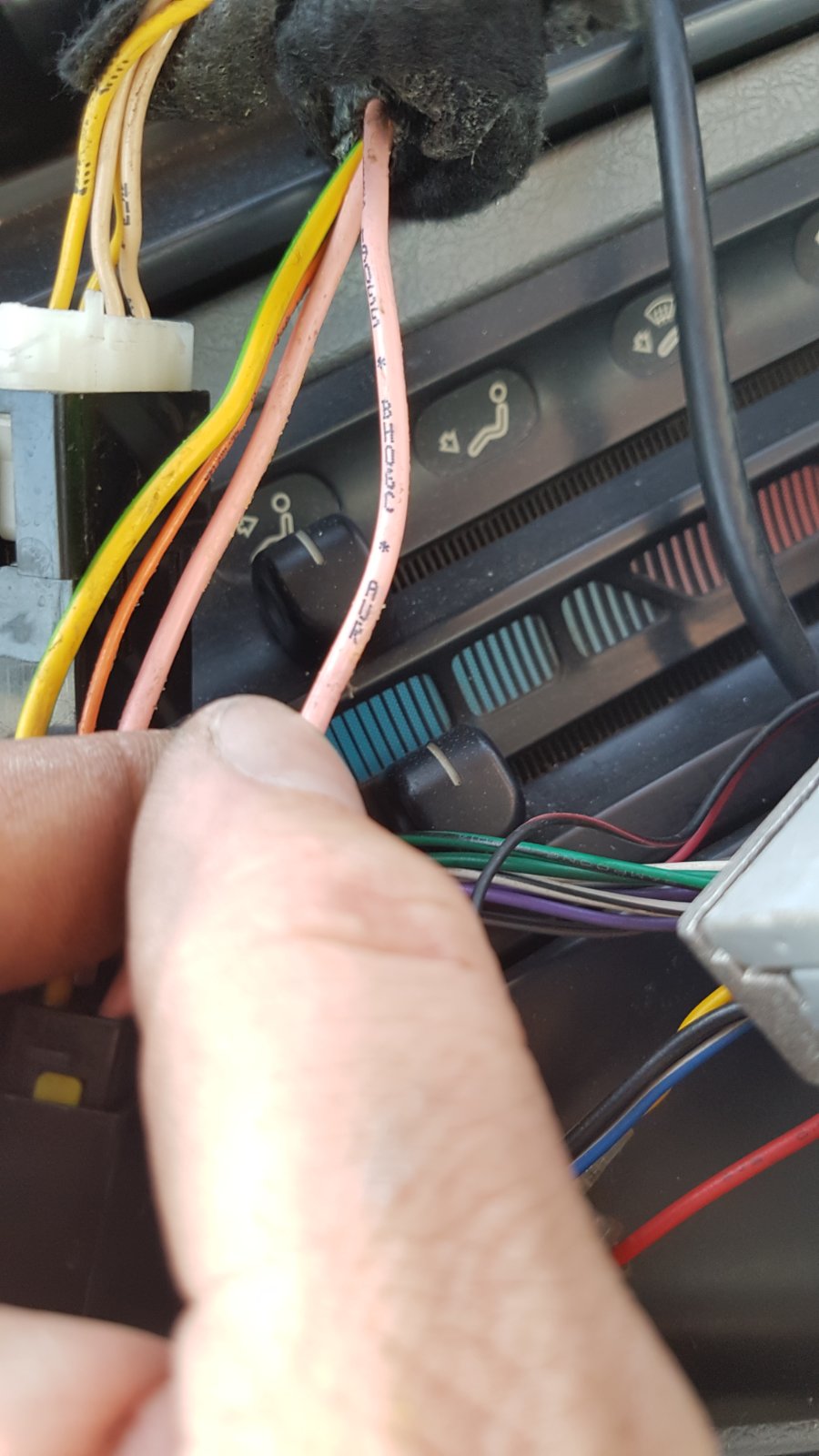

So I have an issue in my van.. the radios switched live does not work. I have swapped the fuse ( numbered 24, 5th fuse down) for other ones that are still fine, swapped the fuse position from ignition to constant live. I have 12v at the fuse but no matter what I can not get 12v through the pink corner wire on the radio power connector. I have no continuity between the radio plug and the right (or middle if you class both fuse positions) pin in the fuse box. For now I am going to wire it in to another switched live source but it would be nice to know where the pink wire goes to. Does it go direct to the fuse box?

Are we talking about the 2005 model in your profile? If so this is a mk2.
The pink wire your holding (BH06C) is meant to be permanent live from Fuse 6, this goes to pin 7 of the radio plug.
The other pink wire (A24) that goes to pin4 of the radio connector is the one that is switchable via fuse 24 between accessories & permanent.
According to the diagram It goes directly from the fusebox to the radio connector without going through any splices or connectors. Might be worth checking the plugs on the rear of the fusebox if there is no continuity.
