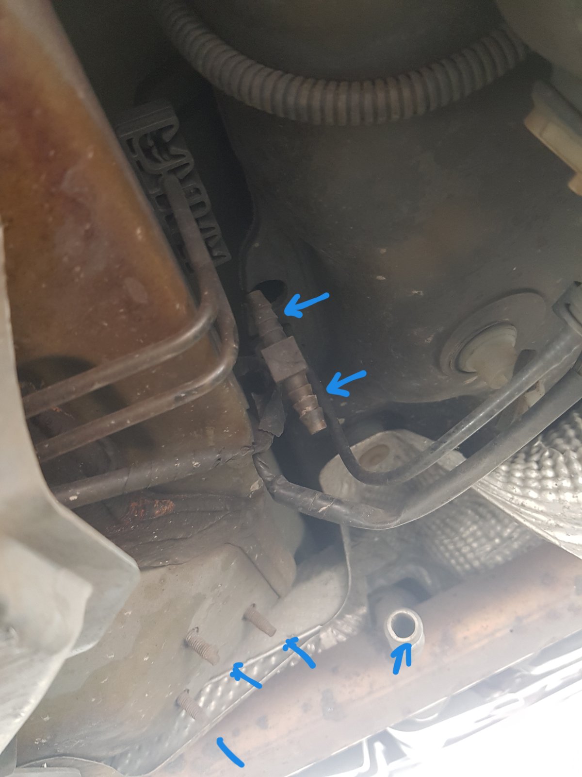

I also am wondering if one item underneath has been removed (last pic )

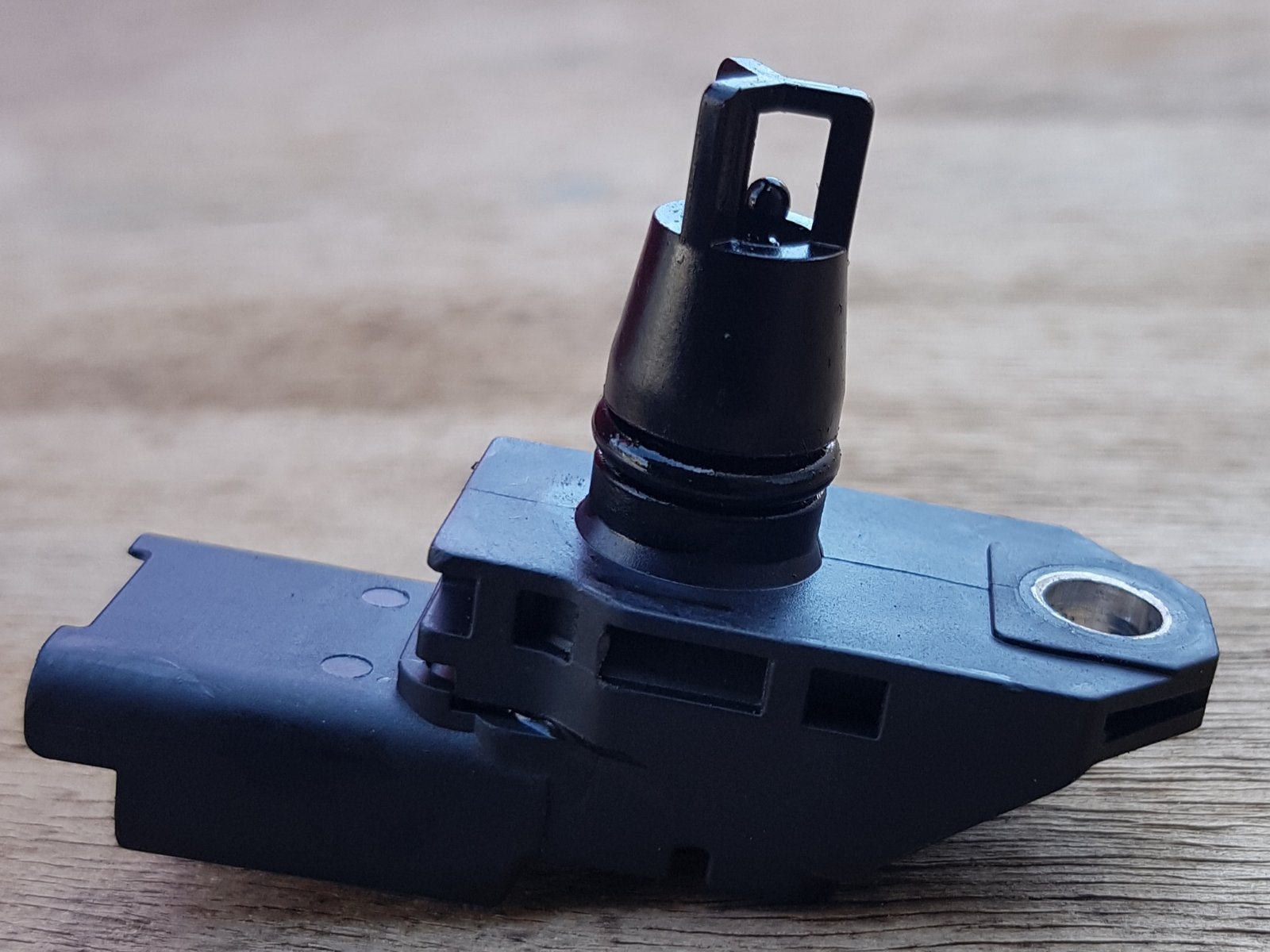

Pic 1 , heat sensor ? , does it need cleaning Pic 2, actuator.. What is it controlling

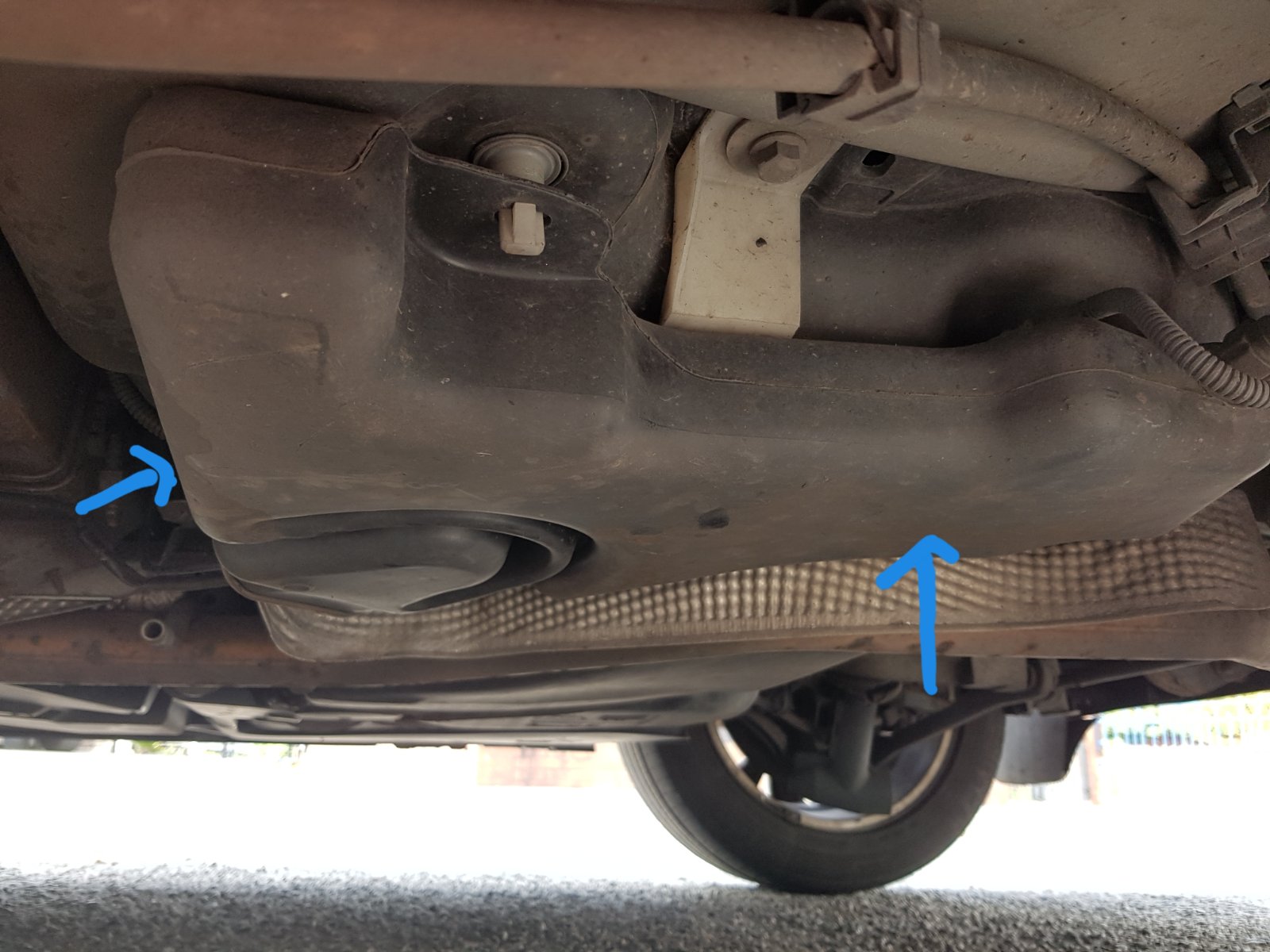

Pic 3, is this the Eolys additive tank.Pic 4, open pipes..something was here?

Picture 1 is the Inlet Air Temperature & Pressure Sensor. These are fragile - the air is split into two channels. One goes to a very small resistor which you might be able to see at the tip, which measures the air temperature, - be very careful not to damage it. The other channel passes the air through up into a diaphragm that measures the air pressure.

Picture 3 is the Additive Tank
Picture 4 - looking into it...

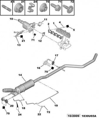

Is that hole a oxygen sensor or something in the exhaust ?
I'll check mine outside, it's familiar when I changed the DPF last year.

... forget that idea, hedge cutting and I can see sod all. But the oxygen sensor is near the front, not the rear, so can't be that.
It can't be the pressure differential sensors either as they are further up:
So this may be a mounting support maybe - Kenny may have the answer here..

Could this be the DPF pressure pipes it's about the same position.
Couldn't see under mine properly!
Just had another look at the photo, it's to far back for the DPF pipe. It is in the same position as the support brackets for the exhaust and on mine there is a single support bracket with the threads in place for a support bracket on the other side.
I don't have an idea now what this could be.
The only other thing I can think of is, has the exhaust been changed and the wrong type fitted ?
Kenny

I don't think so Kenny - if you look at my last post those pipes are before and just after the particle filter (14) in your diagram, Bela's picture shows the pipe is directly next to the additive tank.

So I have a Eolys tank, how do I check if there is still enough inside.

Don't worry about the additive tank - the system will tell you when it thinks it is getting low via a message on the dashboard display.
It is important that when you do come to top it up, that you use the correct additive - for your X7 this will be Powerflex additive only from your build date 12446 - you should have a Blue click fit connector on the additive tank. Do not use Eolys DPX42, nor Eolys 176, nor Infineum F7995.
As for the Air inlet temp and pressure sensor:
DesignationValueUnit
Supply voltage5 ± 0,25V
Pressure measured by the inlet air temperature and pressure sensorBetween 300 and 3000Mbar
Impedance between channels 3 and 4
(Connector disconnected, negative terminal of the ohmmeter on channel 4 )
15 or belowkohms
Impedance between channels 2 and 4
15 or belowkohms
Supply power15 maximummA
