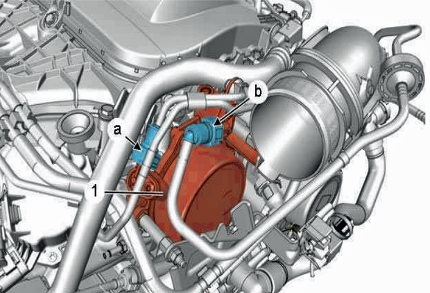

This is how the system works on this engine, which may be worth a read first, then see the last paragraph concerning operation parameters.
Role
To comply with the emission standards, the quantity of nitrous oxide (NOx) thrown out by the exhaust must be the lowest possible.
The exhaust gas recycling (EGR) device reduces the amount of nitrogen oxide (NOx) emitted by the exhaust.
Function
Exhaust gas recycling
In addition to opening the electric EGR valve, the engine ECU orders the air mixer to close partially.
The closing of the air mixer causes:
Cooling of the exhaust gases enables the emissions of nitrous oxide (NOx) to be further reduced.
The exhaust gases are able to be cooled, in order to prevent the total mix of air from reaching too high a temperature (Mixture of inlet air and recycled exhaust gas).
In certain operating phases, the exhaust gases do not have to be cooled before being admitted into the combustion chamber (Notably during cold starts, to allow the engine to warm up more rapidly).
The engine ECU, by means of a pneumatic electrovalve, operates a by-pass by which the exhaust gases go directly to the air inlet without passing through the EGR exchanger.
Initialisation of stops
To mitigate ageing and soiling of the EGR valve, an automatic initialisation of the high and low stops is performed when the EGR valve is at one of these limits for more than 0,5 seconds.
Taking account of the stop positions initialised automatically and comparing them with the original position initialised at the factory, the engine ECU adapts the setting for control of the EGR valve.
Initialisation of stops is not possible if the battery voltage is lower than 10 V or higher than 14 V.
Note: Initialisation can be performed using Diagbox.
Cleaning
To prevent soiling of the electric EGR valve, there is a cleaning phase on switching on the ignition.
This cleaning phase consists of one or more successive opening and closing cycles.
At the end of the cleaning cycle, the engine management ECU tries to reach the upper stop (maximum opening) of the electric EGR valve.
If during this attempt a blockage is detected, the cleaning cycle is repeated.
If, after this second attempt, the valve remains stuck, a fault appears.
Antisticking
The engine ECU estimates the state of sticking of the electric EGR valve, as a function of the following factors:
This signal is followed by a vibratory signal that makes the gate of the electric EGR valve vibrate in order to prevent the sticking.
Note: The amplitude of the vibratory signal depends on the degree of sticking detected by the engine ECU. The antisticking strategy is used only during phases where the electric EGR valve is being operated.
As for the operation of the EGR itself, see the following graph that will give you some indication of operation:
"G" Zone of activation of the electric EGR valve.
"N" Engine speed.
"T" engine torque.

Have a look at my post on this thread here - it gives you the layout of them on this engine:
viewtopic.php?p=643201#p643201

Re: Quick question related to EGR valve
Ok so here are the components of the vacuum circuit:
Here is the Air Supply Circuit:
Key:
"A" Fresh air
"B" Cooled compressed air
"C" Hot compressed air
"D" Air inlet
"E" Exhaust gas
"F" Control vacuum
"G" Electrical links
(1) vacuum pump. "a" Vacuum reserve supply. "b" Output to the brake servo unit. | (2) Air inlet manifold with integral vacuum reserve. (3) Breather and filter for all the control electrovalves. "c" Outlet towards the proportional electrovalves controlling the double mixer. "d" Pressure drop inlet for the vacuum pump. "e" Outlet to electrovalves: Proportional electrovalve controlling the variable resistance turbocharger Control electrovalve for the EGR heat exchanger by-pass | (4) Proportional electrovalve controlling the variable resistance turbocharger. (5) Cold air circuit electrovalve. (6) Hot air circuit electrovalve. (7) Variable geometry turbocharger. |
