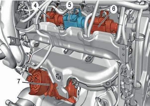

This is how the system works on this engine, which may be worth a read first, then see the last paragraph concerning operation parameters.
Role
To comply with the emission standards, the quantity of nitrous oxide (NOx) thrown out by the exhaust must be the lowest possible.
The exhaust gas recycling (EGR) device reduces the amount of nitrogen oxide (NOx) emitted by the exhaust.

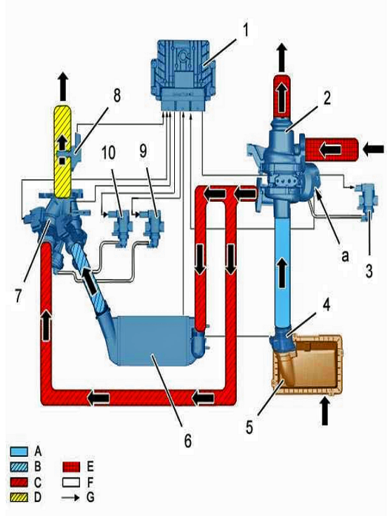

Exhaust gas recycling
In addition to opening the electric EGR valve, the engine ECU orders the air mixer to close partially.
The closing of the air mixer causes:
Cooling of the exhaust gases enables the emissions of nitrous oxide (NOx) to be further reduced.
The exhaust gases are able to be cooled, in order to prevent the total mix of air from reaching too high a temperature (Mixture of inlet air and recycled exhaust gas).
In certain operating phases, the exhaust gases do not have to be cooled before being admitted into the combustion chamber (Notably during cold starts, to allow the engine to warm up more rapidly).
The engine ECU, by means of a pneumatic electrovalve, operates a by-pass by which the exhaust gases go directly to the air inlet without passing through the EGR exchanger.

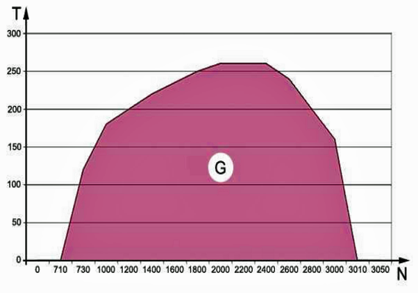

As for the operation of the EGR itself, see the following graph that will give you some indication of operation:
"G" Zone of activation of the electric EGR valve.
"N" Engine speed.
"T" engine torque.
The electric EGR valve is deactivated in certain operating conditions:
- The high temperatures, caused by the excess air combustion mode proper to diesel engines, produce a large amount of nitrous oxide (NOx).
- The admission of exhaust gas into the combustion chamber reduces the quantity both of oxygen and of nitrogen present at combustion.
- The temperature of combustion is then lessened, which reduces the amount of nitrous oxide (NOx) emitted.
- Some of the exhaust gas is diverted into a duct linking the exhaust to the air intake.
- This duct is closed by an electric EGR valve.
On the command of the engine ECU, the electric EGR valve opens, giving the exhaust gases a controlled access to the inlet manifold.
- A vacuum in the inlet manifold, drawing in the exhaust gases
- A diminution of the amount of air entering

This signal is followed by a vibratory signal that makes the gate of the electric EGR valve vibrate in order to prevent the sticking.
Note: The amplitude of the vibratory signal depends on the degree of sticking detected by the engine ECU. The antisticking strategy is used only during phases where the electric EGR valve is being operated.
"N" Engine speed.
"T" engine torque.
- Under conditions of engine speed and engine torque defined by the zone of activation "G"
- At idle for a maximum time of 300 seconds
- Engine torque below 140 N.m
- Engine speed below 2500 rpm
- Coolant temperature between 15°C and 60°C

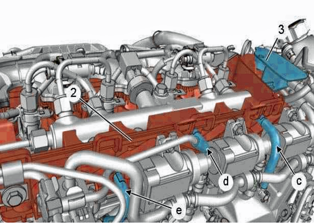

Have a look at my post on this thread here - it gives you the layout of them on this engine:
viewtopic.php?p=643201#p643201

Ok so here are the components of the vacuum circuit:
Here is the Air Supply Circuit:
Key:
"A" Fresh air
"B" Cooled compressed air
"C" Hot compressed air
"D" Air inlet
"E" Exhaust gas
"F" Control vacuum
"G" Electrical links
(1) vacuum pump. "a" Vacuum reserve supply. "b" Output to the brake servo unit. | (2) Air inlet manifold with integral vacuum reserve. (3) Breather and filter for all the control electrovalves. "c" Outlet towards the proportional electrovalves controlling the double mixer. "d" Pressure drop inlet for the vacuum pump. "e" Outlet to electrovalves: Proportional electrovalve controlling the variable resistance turbocharger Control electrovalve for the EGR heat exchanger by-pass | (4) Proportional electrovalve controlling the variable resistance turbocharger. (5) Cold air circuit electrovalve. (6) Hot air circuit electrovalve. (7) Variable geometry turbocharger. |
Key:
"A" Fresh air
"D" Air inlet
"E" Exhaust gas
"F" Control vacuum
Reference | Designation |
"a" | Turbocharger blades control diaphragm (With position copy sensor) |
(1) | Engine ECU |
(2) | Variable geometry turbocharger |
(3) | Proportional electrovalve controlling the variable resistance turbocharger |
(4) | Air flowmeter by mass |
(5) | Air filter unit |
(6) | Turbocharger air cooler |
(7) | Double air mixer with position repeat sensors |
(8) | Inlet air pressure and temperature sensor |
(9) | Turbo air cooler by-pass control electrovalve |
(10) | Air metering unit control electrovalve |
