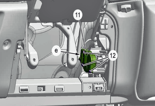

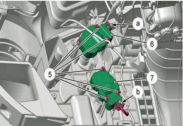

Re: Citroen c4 2009 heater actutor problems
Ok, so you do only have the 'Single Air Conditioning' system.
There are 3 systems on this model - the single A/C system that you have, then a Dual Zone system and finally a 4 zone system.
So you should have the main controls on the driver's side and the single dial on the passenger side that you press to take over the control of the temperature only - with the two temperature + and - buttons to adjust the temperature.
So the temperature and air distribution are set for all zones based on what the driver sets it to.
These should be the mixing micromotor on the left:
and on the right:
and on the right:
Ok thanks mine looks slightly different to the diagram, I have the actuator on the passenger side but it moves an arm (white plastic)on the side of the main heater box. There are also arms on driver side. Problem is when the actuators move, the arms on each side move in different direction. Say I turn the dial to cold the drivers side will move up and the passenger side moves down(causing different temps on each side of the car), If I take off the actuator and move the passenger side arm up manually all temp Match throughout the car. ?? Just can’t seem to get actuator to move in sync???
