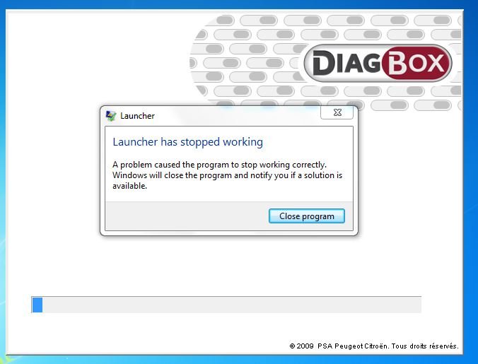

Re: Diagbox software digital down load.
I've finally managed to download an ISO. image from ED's provider. Numerous attempts- numerous failure notices, but in the end a disc image is mounted.
Diagbox v 7.01 successfully installed! Restarted PC- reopened Diagbox- it notifies an update in progress and then this:-
Marc- help!
Marc- help!

- x 6960
I would be a little concerned about the numerous failures you mentioned, as any problem in a single installation can affect operation - ans may have thrown some issues into the mix....
But first a few things to check:
When you installed it initially and completed the installation to the point of putting in your information (address, postcode & phone section), you would click the option to 'Validate'. At this point, you don't restart the PC, you must first close down the Diagbox application.
When Diagbox has finished closing (make sure it has fully closed), then re-launch Diagbox.
This starts to automatically apply the built in update that takes it to version 7.01.
Then restart the computer.
You would then install the next update you want, then start Diagbox, then it applies the update on launch. Allow it to finish, then restart the PC again. Then repeat to apply the next update, launch Diagbox, allow it to update itself, close, the restart PC, etc.etc.,
If you are not getting to this stage then it has failed to install properly I suspect.
Always right click the installation setup and 'Run as Administrator' and always allow all firewall requests to go through.
The failures I mentioned only presented when downloading the ISO. Once it appeared to download OK it [somehow] automatically found the virtual drive that you recommended. All went well- v7.01 installed- I then closed the programme. Perhaps restarting at this point was a mistake- maybe I should have simply relaunched Diagbox.
Guess I'm going to uninstall/ re install and see what happens
