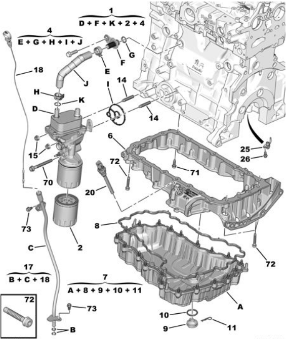

x 6957
Re: Citroen C5 2.0HDI 2016BlueHDI 150 Engine Repair light
Here's the parts diagram showing the oil filter Tony, item (2):
Click Image to magnify
