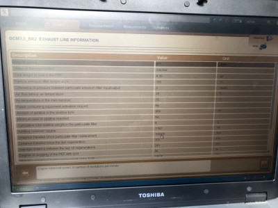

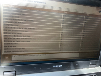

Before I pray about having to save up some pennies, I took a couple of photos of the current DPF and EGR values on Diagbox incase they give any insight. Hopefully they are clear enough to make something out of them. Also on a tangent, i saw something which said "Controlled air inlet module" which was absent. Out of interest, what is the controlled air inlet module?

Re: Exhaust sooting possible DPF Pipes
The main thing I noticed on picture 2 is the degree of soot clogging in the filter shown as 94%! Anything over 75% can lead to permanent clogging as filter gets so full that it makes any regeneration impossible.
Are you getting any warning on the dash concerning the risk of the particle filter clogging? I would be surprised inf not given this level of soot loading.
Next, your average regeneration distances are at the lowest end, meaning your car is not getting a good run for any length of time, resulting in more frequent assisted regeneration cycles. If these get interrupted as I said before (like the engine being switched off inadvertently in the middle of a regeneration), then it will employ various strategies to try and regenerate more quickly the next time, until it gets to the point where it cannot.
So I would be very wary of this as 94% clogging means it is almost totally full of soot.
Your additive level is about 1 litre or just under, so it thinks there is enough additive in the system. So if you are aware it is trying to regenerate, then it may not be able to clear this level of soot.
