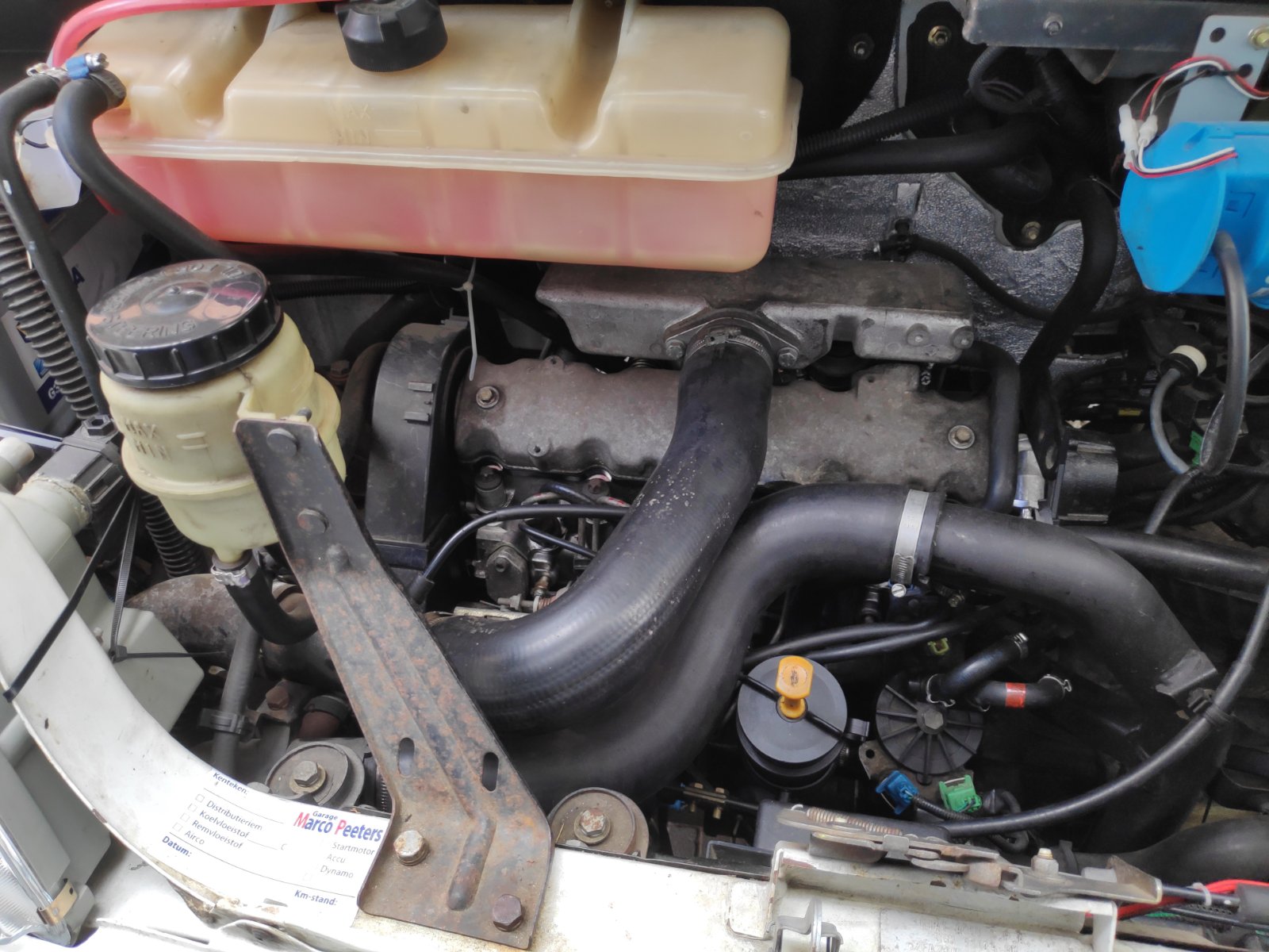

Now for my question. After closing I just filled the large cooling liqued container again. Is this sufficient or do I need to do more? I read about bleeding points and so on. My coolant tank is way above the motor itself (see picure). Is bleeding necessary? And if yes, what is the easiest way to do this at home?

Re: XUD9 cooling water unintentionally spilled! Cannot find coolant bleed points.
Hard to see from the photo, but that 'may' be one just to the right of the green plug? It looks like a plastic hand operated one. If it is be careful, they break. Don't take any of what I've said as gospel, I don't know that configuration.

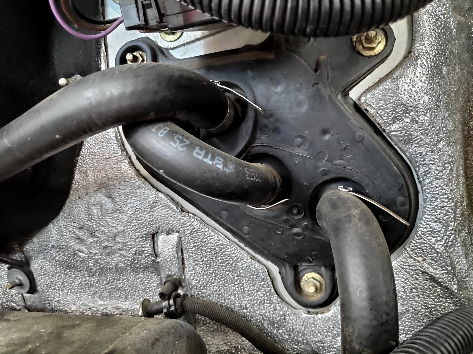

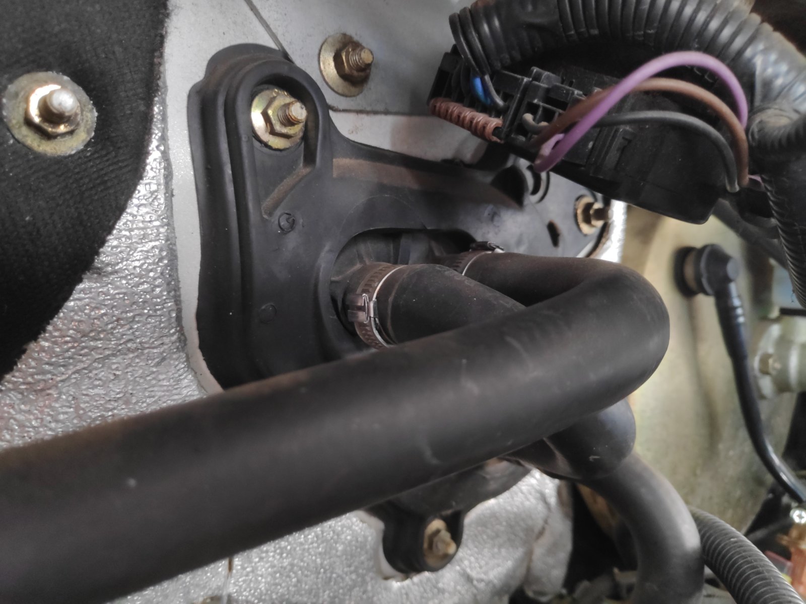

A service manual/owner's book would help
Guesswork would be: thermostat housing, radiator top, radiator top hose, hoses going through firewall to heater matrix, and any 'high points' on the system. Easy to overlook a vital one.
Having the coolant tank up high helps drive air out, but bleed screws still need to be opened.

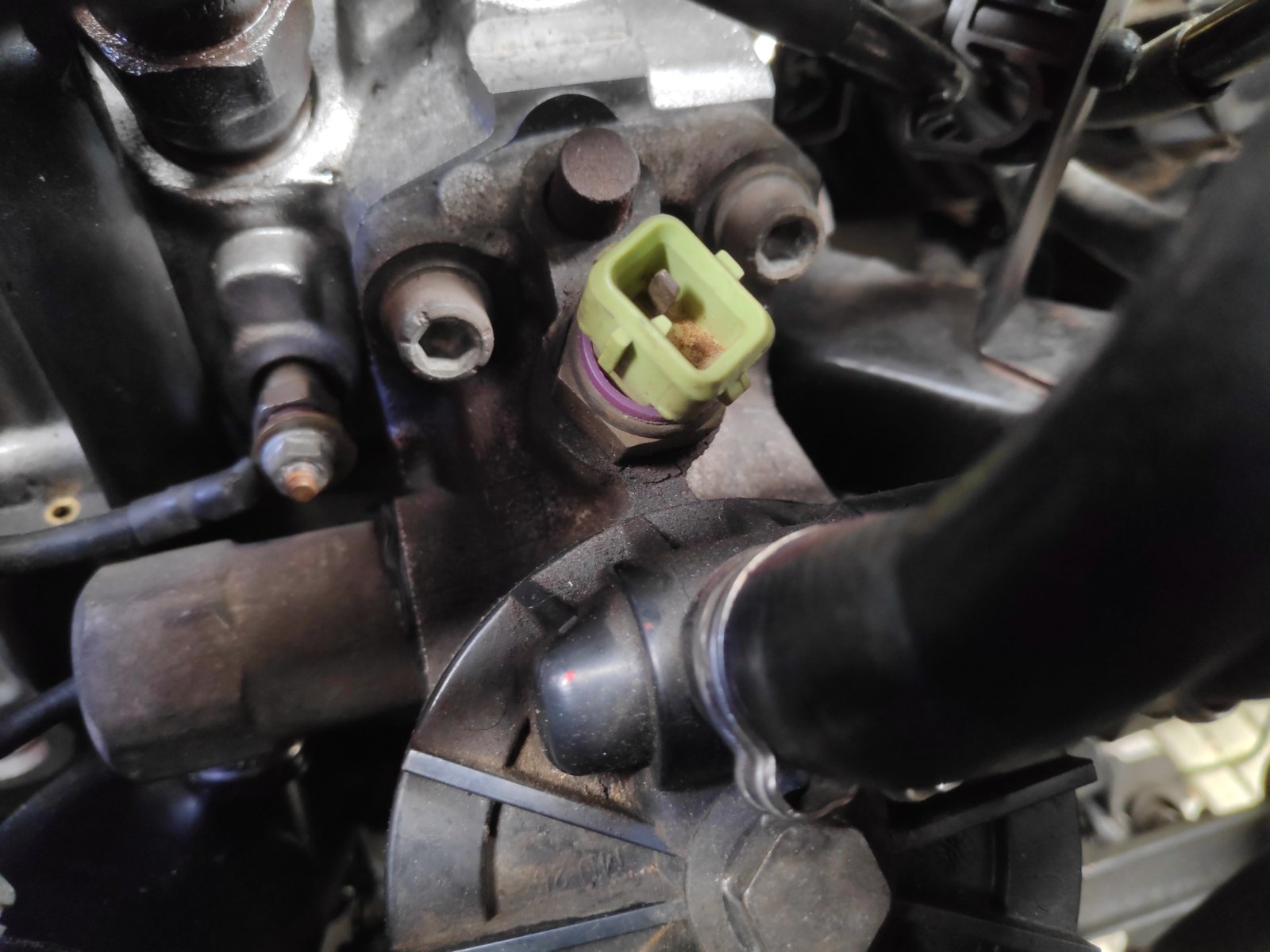

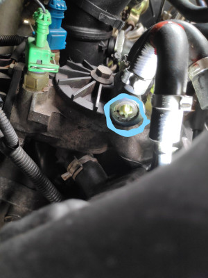

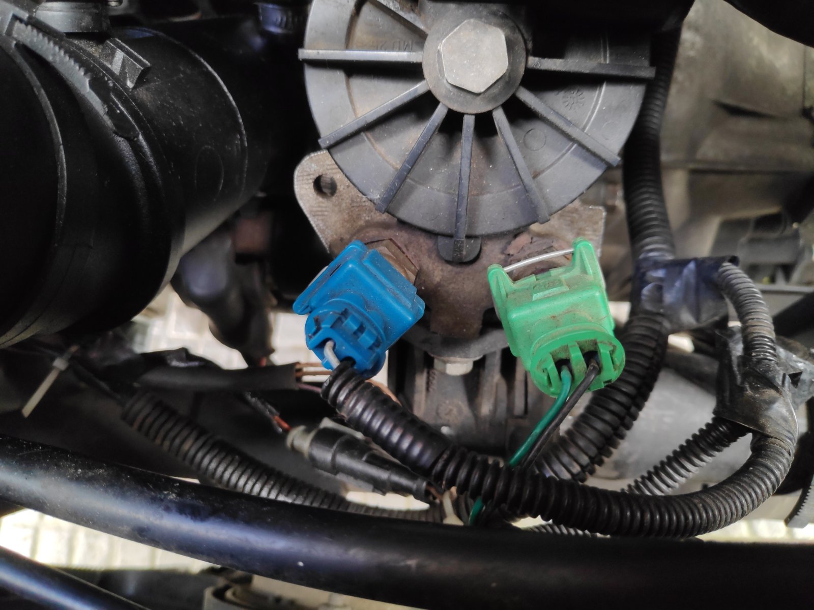

This morning I checked again and made some pics. Hopefully someone can help me out. Every description I might make here is looking from the front of the engine.
I have been looking at the places you adviced but am really puzzled. The search for bleed screws....
I had a look at the PSA instructions for bleeding this engine, but they are generic, not specific to the vans, and although a bleed valve is mentioned, it is not clear that there actually is one in all installations.
In the bottom photo, there is a connector with no plug, just above it is a round cap. That cap may be the bleed point, or it may just be capping off a port that is not used in this installation.
In the last picture right above the sensor that is not connected, is you bleeder screw, if that is not you can always unscrew that sensor, most importantly is you to get coolant behind the thermostat, so it can work. Peugeot thermostats have rubber seal and they are often airtight so coolant get to the thermostat to heat it up.
That plug at the top of the 'stat housing could be a bleed point, or it could be an (unused) take-off point for the expansion tank on other models.
It you can't find the bleed screws, then removing/slackening the sensor is a reasonable way forward, although really unusual.
