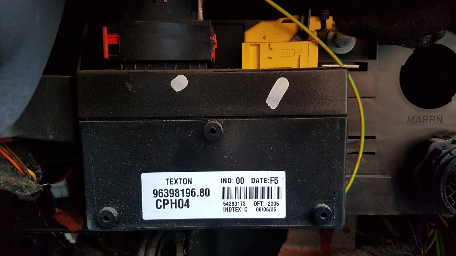

I have attached some photos of the plugs and maybe this CPH of which you speak of, though the yellow connector tells me it has more to do with the SRS/Airbag system?
Hmm I guess I'll break out the clamp meter and check what wire starts drawing amps when I turn things on.
I will post up all of my findings. And report back what wire colour and code connects to what.
At least they use green and yellow for the earth.
Thanks for the reply

Yes the CPH is like a basic body control module and that is it in the bottom picture.
You should be able to pick up battery live, ignition live, indicators, door switches & central locking here
Not always so dont get caught out.

Re: Dispatch 2005 wiring colours help
Cant confirm exactly as I don't have your RP number
on the 15 way Black connector:-
Pin 5 = Igniton live (confirm this doesn't drop out on crank if using for an alarm)
Pins 1 or 4 = battery live
Pins 8 & 14 = central locking pulses
Pins 2 & 10 Indicators
On the 26 way Yellow connector:-
Pin 1 = Right door open switch
Pin 3 = Left door open switch
