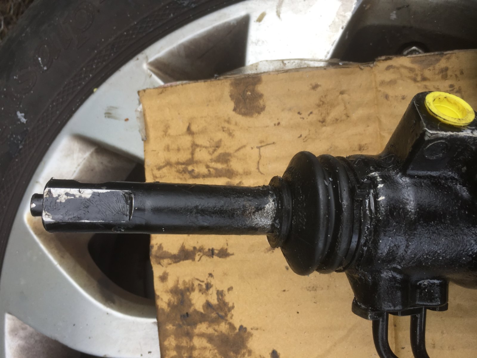

KennyW wrote: 07 May 2020, 17:35 Image
That does look a really tidy gaiter job with the lump removed, Kenny. Well done!
Should have been like that ex-factory.

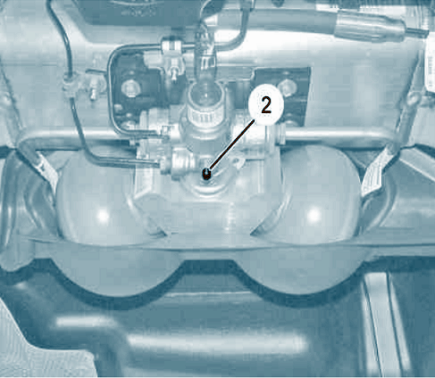

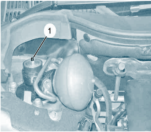

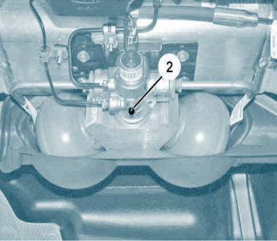

You can manually depressurise the front and rear axles independently Kenny, but you'll need it on axle stands, or you won't be able to get under to turn the pressure release screw at the rear. However, be aware that you will lose fluid this way using the manual bleed methods:
Once you have the car on the axle stands, remove the LDS cap and place the car on the lowest suspension setting.
Disconnect the battery
Depressurising Front Axle
  • Place a hose on the pressure release screw (1).
  • Gradually unscrew the pressure release screw (1).
  • Wait for the pressure in the hydraulic circuit to fall fully.
  • Place a hose on the pressure release screw (2).
  • Gradually unscrew the pressure release screw (2).
Depressurising rear Axle
With both depressurised, then you can top up the reservoir until it's between 'a' & 'b':
