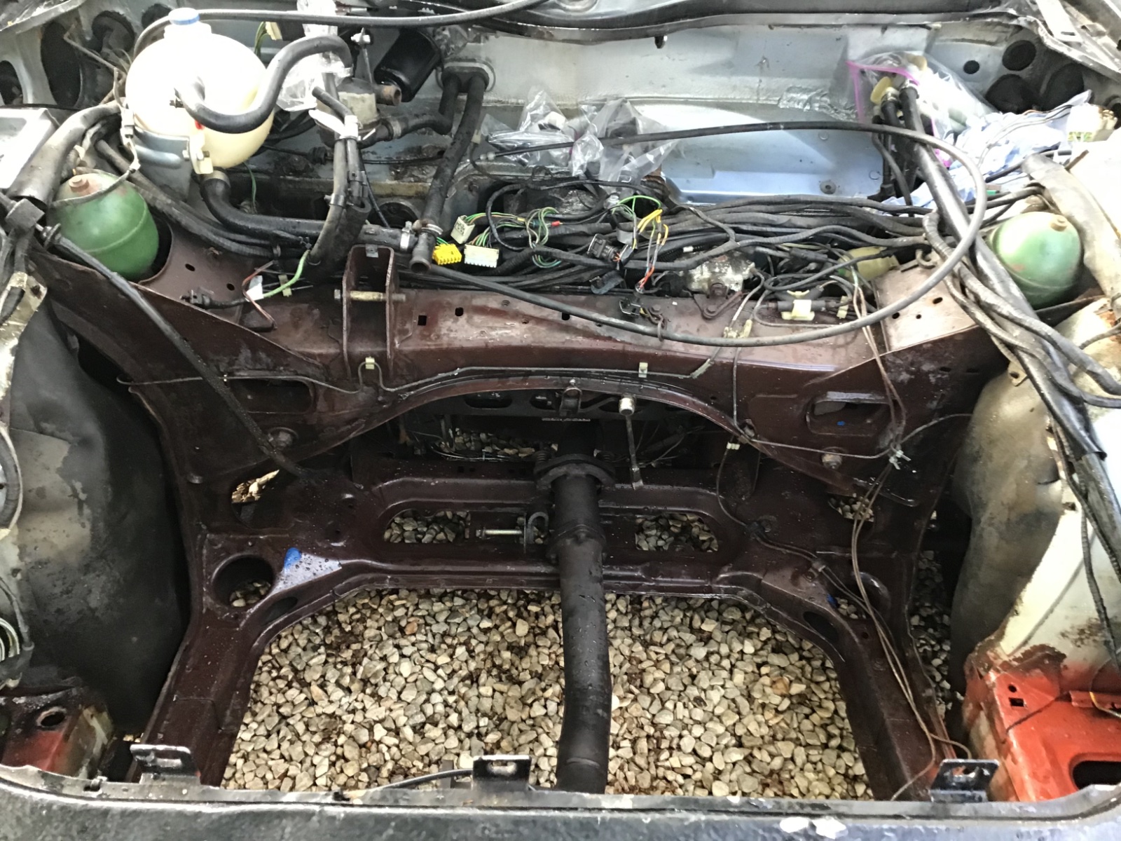

In the meantime I’ve stripped away heater tower, bulkhead sound deadening, etc, in prep for a trial fit of the heating/A/C unit that I’m going to replace ALL of the woeful CX ventilation and ludicrously complicated wiring with
I’m not going to run an under bonnet spare wheel, or metal plate, or bent metal brace, and hopefully most of that shocking loom that runs across the top of the bulkhead will be gone too

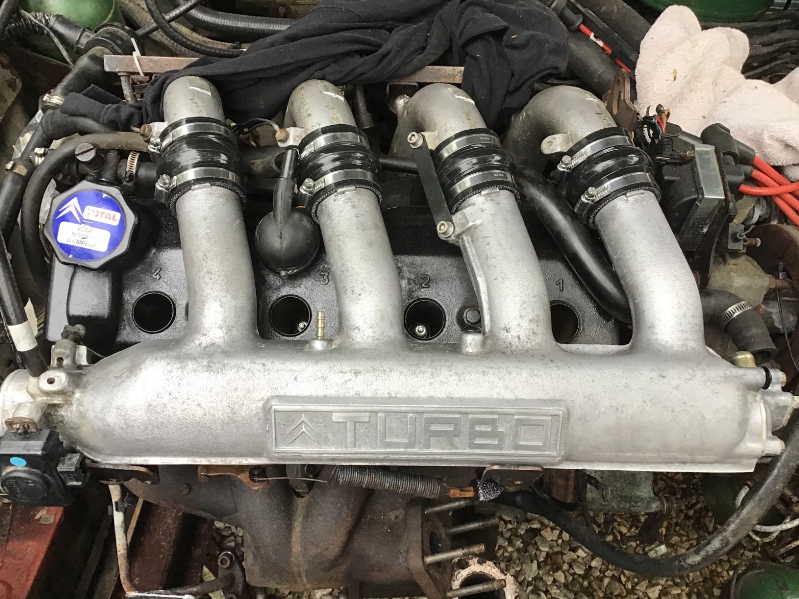

So, a bit of progress, new hoses and clips and some cleaning...

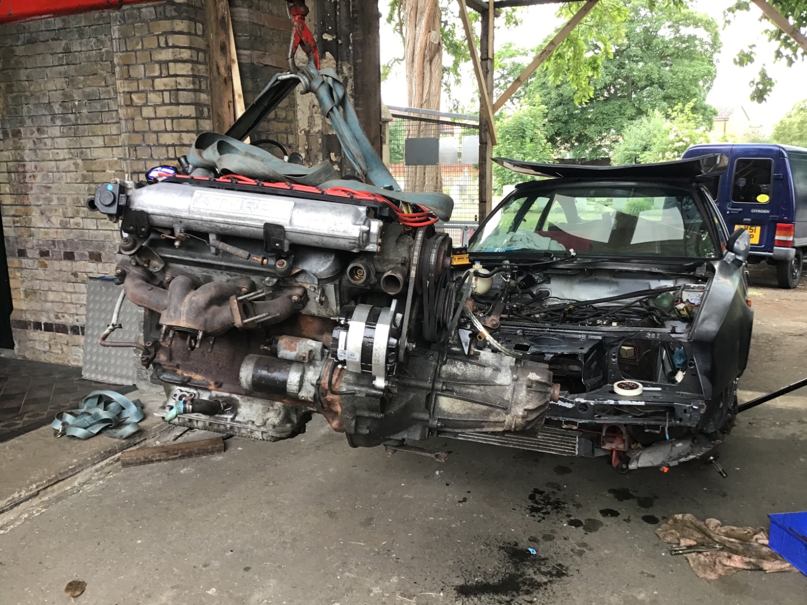

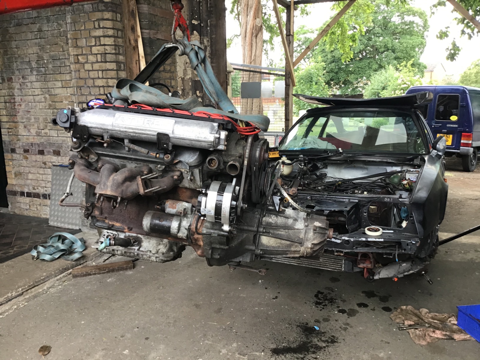

Well, engine now out
Bilkob
- Posts: 169
- Joined: 23 Feb 2017, 19:16
- x 47
Re: GTI Turbo on Motec or other...?

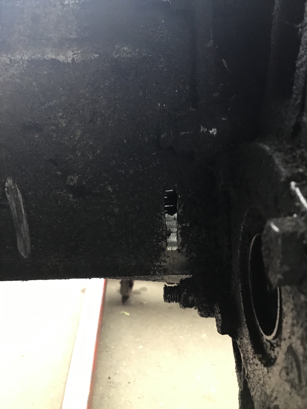

Well, taking the engine out of a CX was as much fun as I,d anticipated...
There were a couple of reasons for taking it out, one, it just seemed the right thing to fit a new clutch, and I also wanted to completely renew all the engine bay hydraulic lines, so in that vein, the car is off to Plaeides sans engine. I also plan to fit a DTR T2 ‘box.
It’s a good job I did take it all out as it’s revealed that someone has secured the L/H driveshaft with a jubilee clip that has munched through the gearbox casing....
