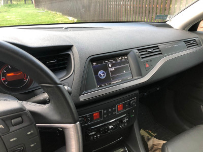

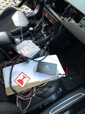

Already done: (RNEG2 install, car audio upgrade):
  • RNEG2 screen with its bezel and head-unit installed
  • roof console fitted with FAKRA GPS antena, USB extension cable for a soon-to-be-installed dash cam and mic for RNEG2
  • custom harness made so not to cut the OEM cables
  • Pioneer DSP installed and wired: two fuse-taps used (one for power, one for ignition-only power), custom harness utilised to receive the RNEG2's audio signal
  • audio cables wrapped in protective loom and fished through the headliner away from the airbags, extra cables wired for additional speakers at the back shelf (for audible parking sensors)
  • tweeters replaced with Clarion tweeters
  • crossovers installed behind the glove box (LHD) and connected
  • door pockets in all 4 doors treated with sound dampening butyl/aluminium mats, OEM moisture-barrier also replaced with butyl mats
  • Clarion speakers installed on aftermarket rings (separated set for the front, coaxials in the back doors)
  • custom-made sub-woofer enclosure fitted to the trunk's right pocket and shallow-mount subwoofer installed
  • amplifier mounted into the trunk's left pocket
a lot of work! :P I will visit a car mechanic to ask for help fishing that power wire through.
