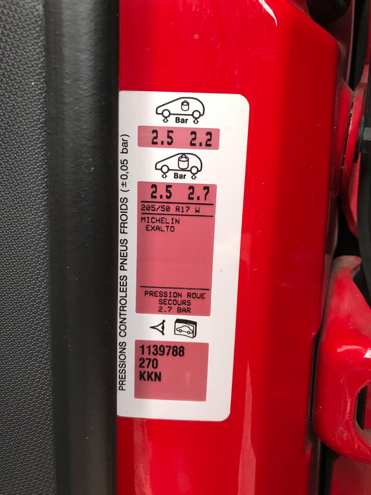

Does the car have ESP? What is the RP number? This is the one circled below on the tyre pressure label.

I'm not sure about the ESP.
RP number is 1139788

Im guessing the last 2 digits of the RP number are wrong? should be 2 letters at the end.

RP number is right.
