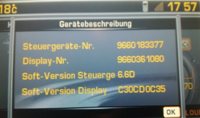

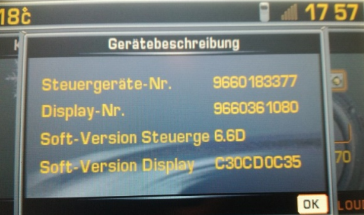

But what is the firmware version being reported by the system?
1) Switch the power on
2) Hold down the MENU button until you get the extended menu
3) Select DEVICE DESCRIPTION
4) The software version will then appear
This is in German, but this is the screen that will tell you - in this case 6.6.
Depending on the outcome I may know of a trick.
