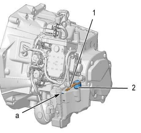

Where I can check oil level for Piloted Manual Gearbox in C5 2011?
OnlineGiveMeABreak
- Posts: 37412
- Location: West Wales
C5 MK I 2.0 HDi SX Wicked Red
C15 Romahome White
XM 2.0 SX Polar White
CX 20 Polar White
GS 1220 Geranium Red
GS 1000 Cedreat Yellow - x 5741
Re: Egs gearbox problem/ help needed
Ok, so I think you are referring to the hydraulic oil in the piloting actuator?
You need Diagbox to do a proper check as the oil must be checked after depressurising the piloting actuator.
Carry out:
Fill via the cap shown at (2)
SELENIA oil
TUTELA CAR CS SPEED
SAE 75W (Part number 9979.A4)

Carry out:
- Top up with oil if necessary
- Pressurise and bleed the hydraulic circuit
SELENIA oil
TUTELA CAR CS SPEED
