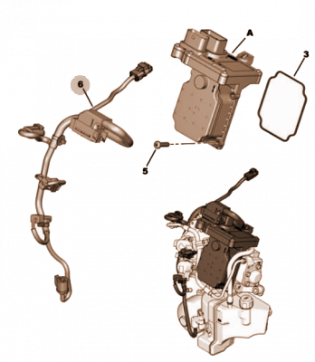

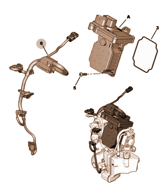

If it's electrical burning / smoking as opposed to oil, then your fuse box is where I would be looking - either that or the gearbox ECU. Below is the Electro Hydraulic Harness I mentioned in my fault code, and the Gearbox ECU is shown at 'A'. So I'd also be checking the connections to all these plugs shown on the harness to make sure nothing has got in there causing a short.

Are these accessed from the wheel arch ?

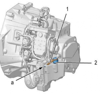

Where I can check oil level for Piloted Manual Gearbox in C5 2011?
- x 6947
Re: Egs gearbox problem/ help needed
Ok, so I think you are referring to the hydraulic oil in the piloting actuator?
You need Diagbox to do a proper check as the oil must be checked after depressurising the piloting actuator.
Carry out:
Fill via the cap shown at (2)
SELENIA oil
TUTELA CAR CS SPEED
SAE 75W (Part number 9979.A4)
SELENIA oil
TUTELA CAR CS SPEED
