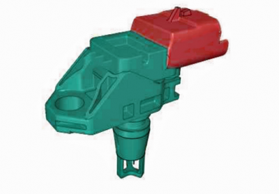

So if you suspect the MAP sensor is faulty, it could be sending the wrong values and having a knock-on effect down the line. It is part 1920QR.
The MAP sensors on these measure both the Air temperature and the air pressure.

Not the MAF kenny, the MAP
Also called the Inlet Air Temperature and Pressure Sensor.
This sensor measures both the air temperature and air pressure and is first on the suspect list in my previous post. It is part 1920QR.

Yes, I'm sure Paul - this sensor is for the manifold specifically.
The incoming air is diverted into 2 sections - one channel goes up and forces the diaphragm up against a resistive plate, which is then converted into an electrical current.
For the air coming through the other channel at 'c' an NPC (Negative Temperature Coefficient) sensor is used to change the resistance in line with the air temperature.
This sensor is specifically for measuring the air and temperature around the manifold.
The MAF also has a temperature sensor Paul, so you are correct there, but they are for different parts of the system.
Here are the components in a representative diagram. I've emboldened the 2 sensors in the table.
| "b" Resistive Plate. "c" Resistor for measuring the air temperature. "d" Diaphragm. |

The MAP, by its nature of having a diaphragm is likely to be a failure area at some point I suspect.

Can you confirm the position of the Map sensor ? Is it located at the rear of the engine besides the electro vlave solenoids ?
Kenny
Kenny
C3 1.4 petrol (SWMBO)
- x 6945
Re: Fault codes
It should be near the manifold air intake, item (7)
