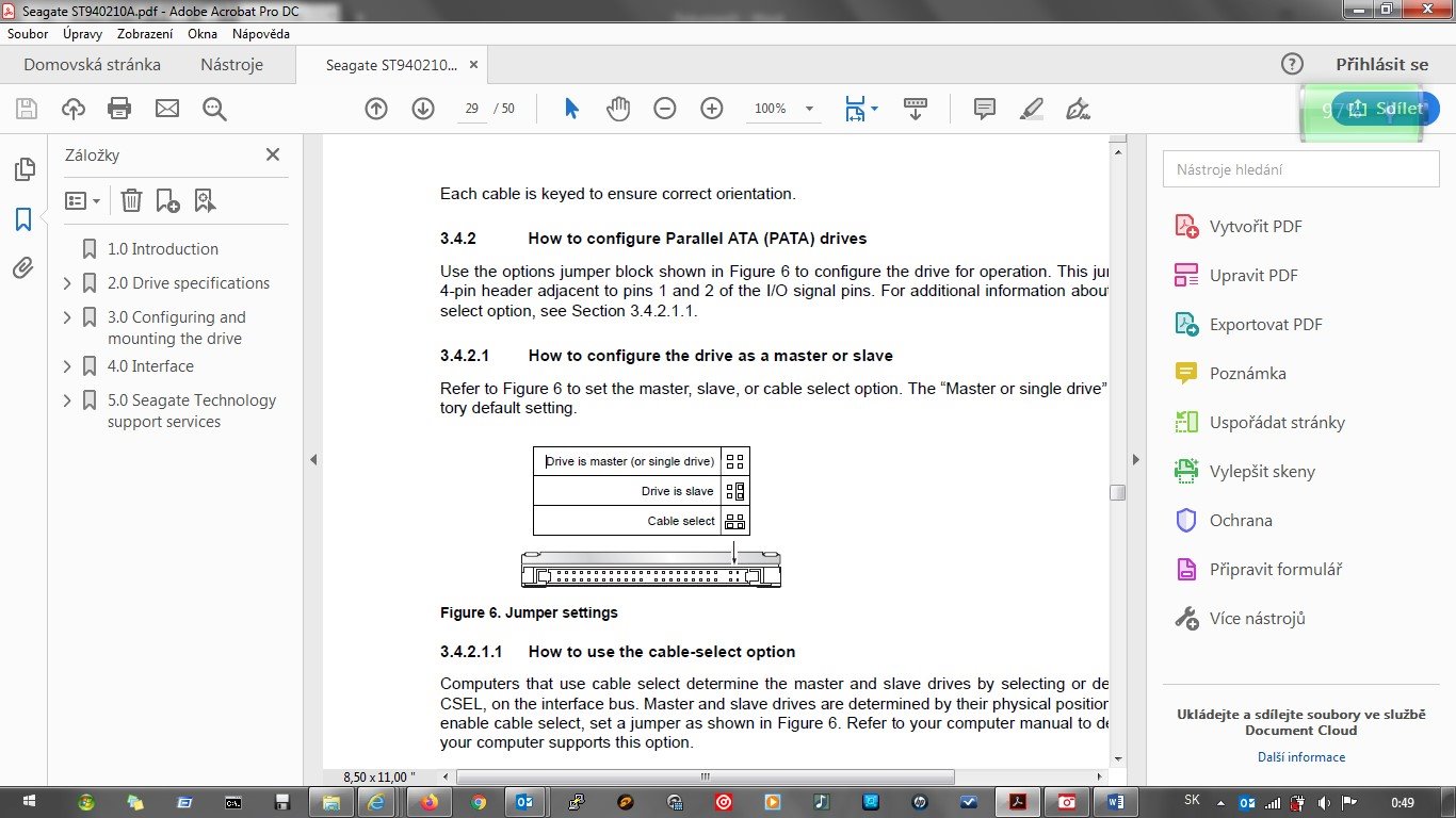

My org HDD Thosiba 40GB replace Seagate ST940210A 40GB - working (Seagate setting jumper MASTER)

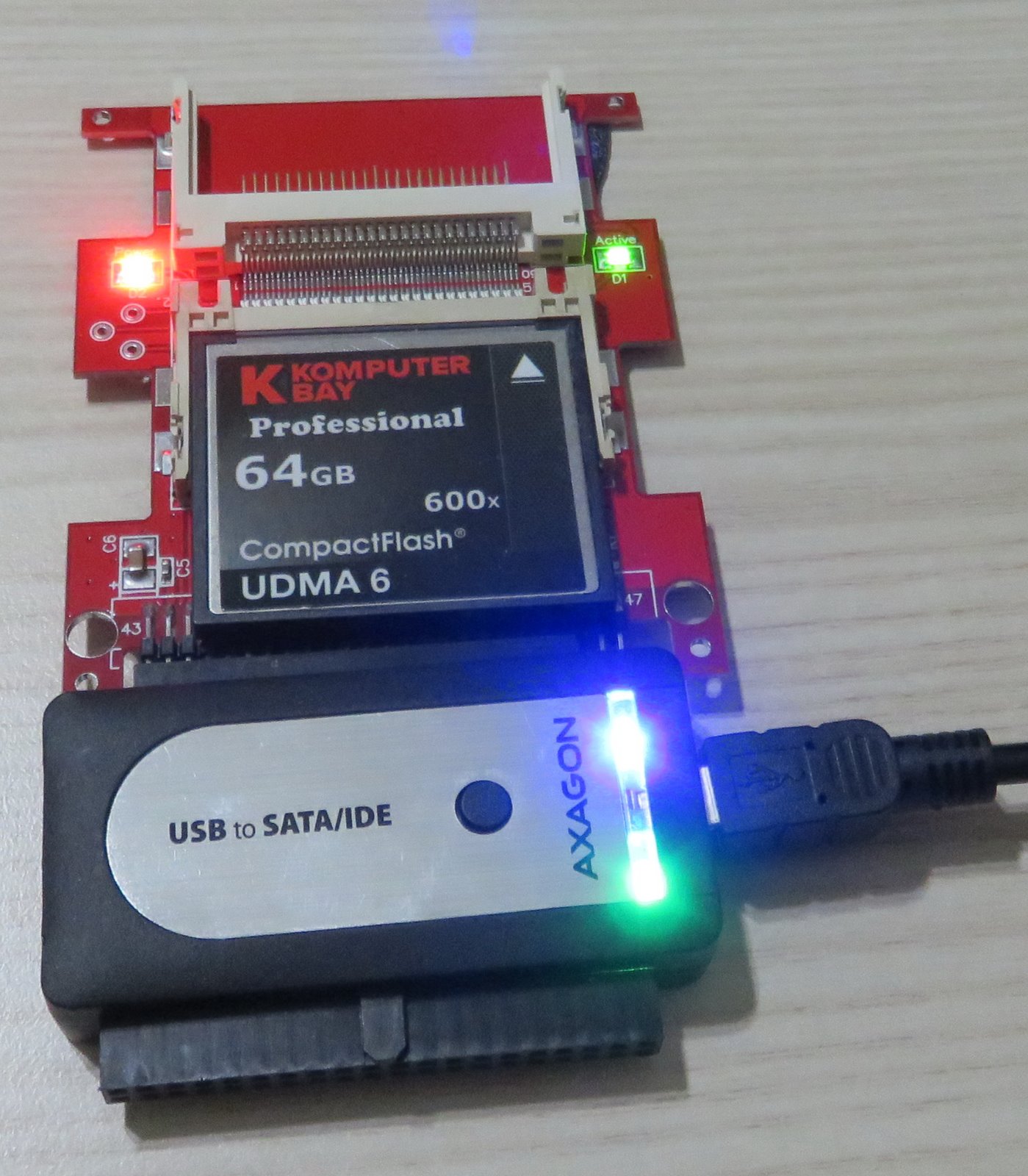

I have CF card - KomputerBay Pro 64GB 600x UDMA6 and 2xCF/IDE adapter - not work
(clone HDD with Clonezilla to CF)

CF card - formating FAT23 (Win7) - Firmware on SD card - not work - internal error 0x3019 - 67%
My firmware on SD card is ok, HDD Thosiba or HDD Seagate - update end 100%
please send my firmware
Sonnic
- Posts: 3
- Joined: 19 Mar 2020, 23:25
Re: Guide to Replacing the NG4 Navidrive 3D Hard Drive with a CF Card
If I will put 2CF/IDE adapter + CF card in NG4, not work USB and DVD drive
Your firmware - copy in USB and SD card
Firmware on USB key - nothing happened
Firmware on SD card - internal error 0x3019 - 67%
I don't have the nerve (I burn my car, NG4, Garage, Notebook, CF card, Adapter - and I will be happy)
This is adapter is bad, not working CF card in NG4

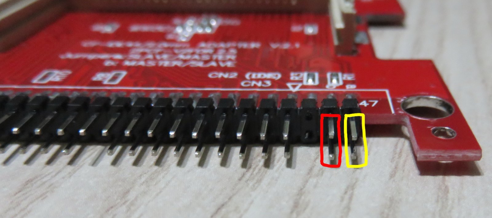

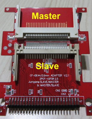

CF slot 1 - master (CN1)
CF slot 2 - slave (CN2)
jumper settings
Yellou - master
Red - slave
soldering this pin? (slave)
I have this adapter - not work

First, the HDD / CF Card IDE interface must be set to slave, as the primary boot device is the DVD ROM and the HDD is the Slave.
