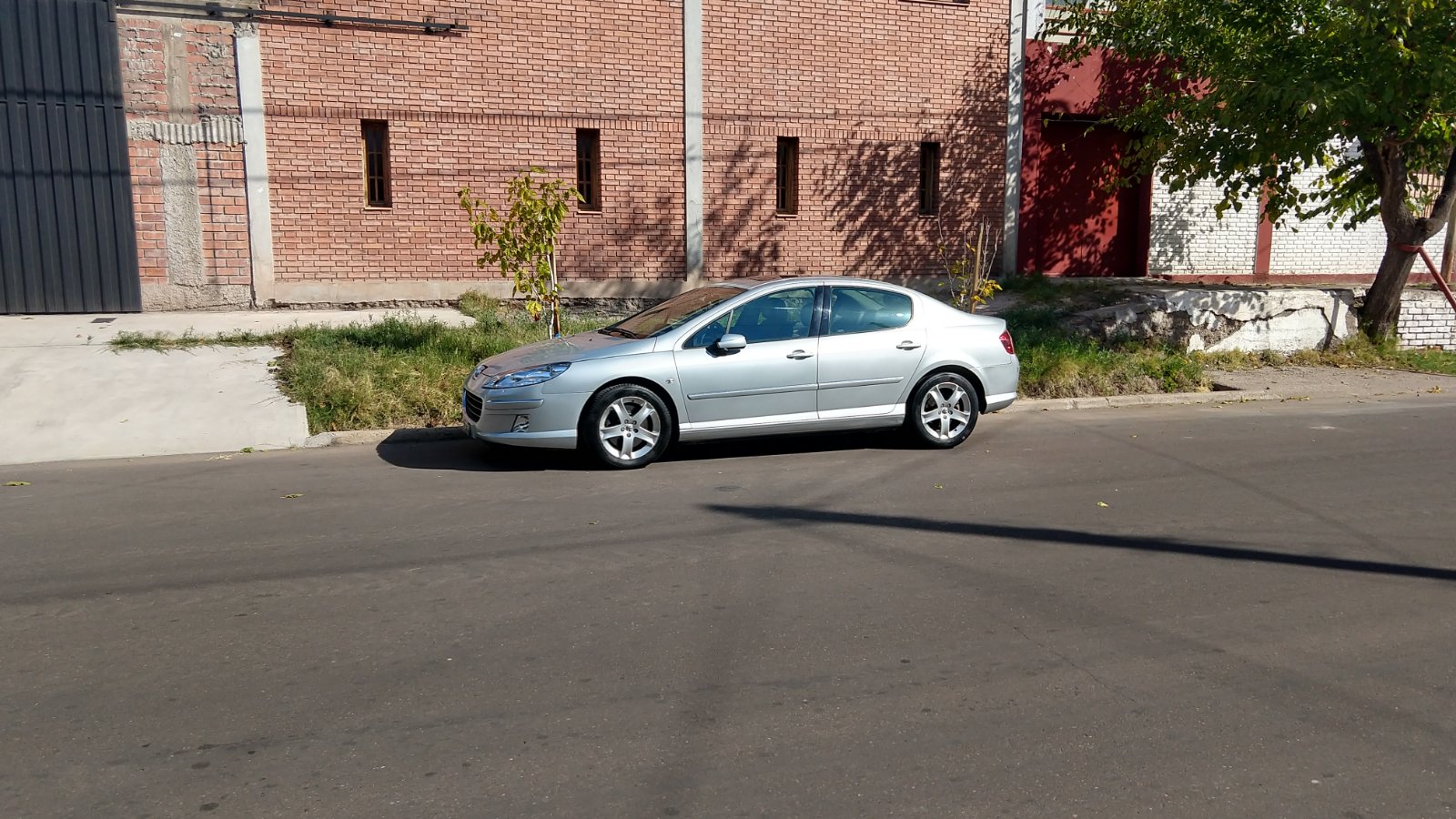

Hi.
Unfortunately, after leaving the car in the sun for 6 hours, the problem continues.
Any suggestion to try?
Cheers
PS: Car photo
