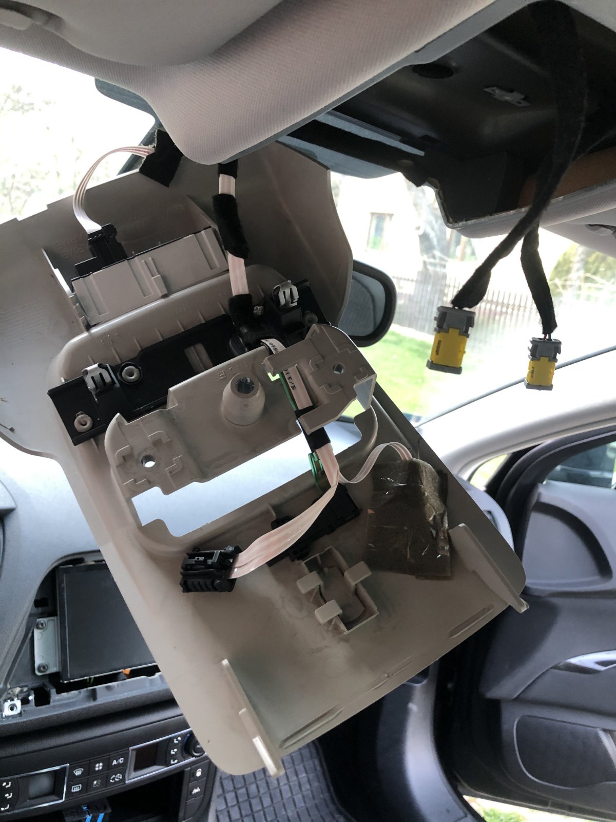

There was no mic in the roof console, although you were right about the ribbon cable - the connector sits there happily waiting for a mic to be installed
By the way, the roof console is a pain to remove.
So, I guess that my question remains valid: can I use this mic with the RNEG2?
See the photo attached, there is a blind where a mic should be.

I've managed to get the RT6 and its dedicated display up and running, thanks to the guides posted here on the forum (especially the RD4 and RT6 input/output pinouts, using the "harness adapter" I built).
The genuine Peugeot mic I used works perfectly.

My roof console now has additional things installed:
The only issue I have: the RT6 head-unit's front panel is black/piano-black whereas the interior of my car is black/dark-gray so they don't color match
(I bought the radio from C3 Picasso, I haven't noticed the color difference until it clicked into place
Some time ago I replaced the cigarette socket under the radio with power adapter. It has two USB sockets facing outside to the driver's compartment and two extra ones on a extension cable facing "inside" the firewall, so that one is able to power up to 4 devices at a time. I hid those extra two sockets under the radio compartment and hooked up my powered phone holder to one of the ports. Now I utilized the second socket to power a dash-cam. I plan to replace the other cigarette socket (rear) with the one I took out at the front (it is illuminated and also clicks-in a cigarette lighter nicely, though I broke it during removal - have to purchase new one
- USB extension cable (plugged into soon-to-be installed dash cam) leading to the area under the radio compartment (described above),
- FAKRA GPS antenna stuck on to the windshield and contained nicely in the roof console,
- microphone from 2016 Peugeot 308 installed to its dedicated area with a custom quick-disconnect allowing for easy roof console removal.
