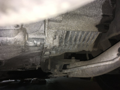

Just in the process of changing my gearbox oil, ML6C.
Confused on the ''does it have cooling fins'' for the correct amount to put in, Mine only has fins on the bottom as per the pic,
My plan was to measure what came out and make a educated guess from there, But ended up with some of it on my workshop floor, due to the drain location.
Any advice greatly received
Oil that came out was very dirty, and metal sludge on the magnet, I don't know how Citroen can say filled for life.....
Steve

Did you discover whether the small finnage was with fins or without fins?
