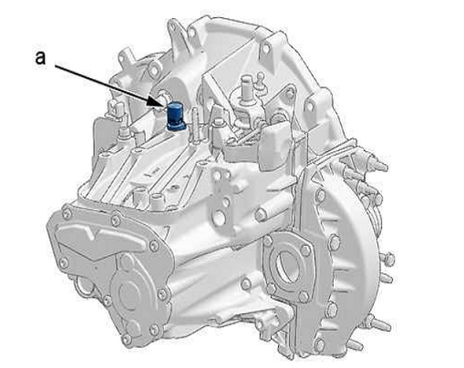

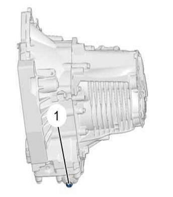

The manuals are lubricated for life, unless a repair is needed, hence no filler port.
In the event of a repair, the exact amount of oil drained needs to be measured and the same quantity replaced.
The engine ideally should be on a hoist (beware of guidance if raising off ground where wheels will be hanging freely on hydractive sysems).
Refilling:
A new seal MUST be fitted to the drain cap. You may need to remove the air filter housing for access.
As for refilling:
For DW Engines (which yours is)
Quantity of oil to fill after draining
Gearbox casing with fins: 1.9 Litres
Gearbox casing without fins 2.6 Litres
Quantity of oil to fill after an overhaul
Gearbox casing with fins: 2.2 Litres
Gearbox casing without fins 2.9 Litres
Oil Type: ESSO 75W80 EZL 848 or TOTAL 75W80 H6965

| For Draining: Remove the drain plug (1) Fitted with its seal. |

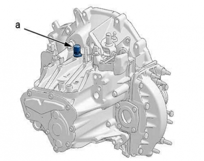

| Refill the gearbox via the air vent hole ( as "a") using tool [0344]. Tool 0344 is basically a Manual gearbox filling cylinder |

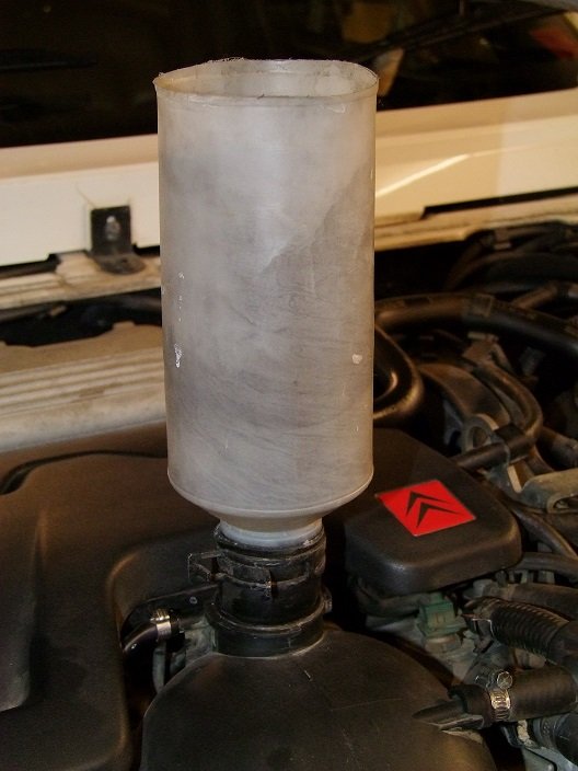

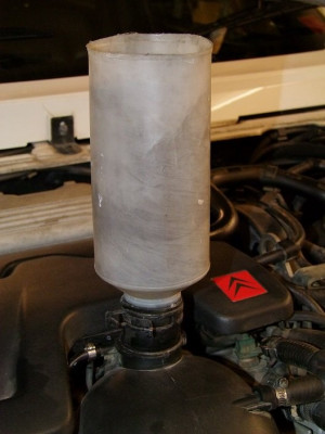

DIY filler, which provides a "head" of coolant, to help bleed out trapped air.
1L bottle, short length of old hose fits into filler neck, and also seals off the overflow hole.

I see that Blue Peter has not been wasted on Chris.

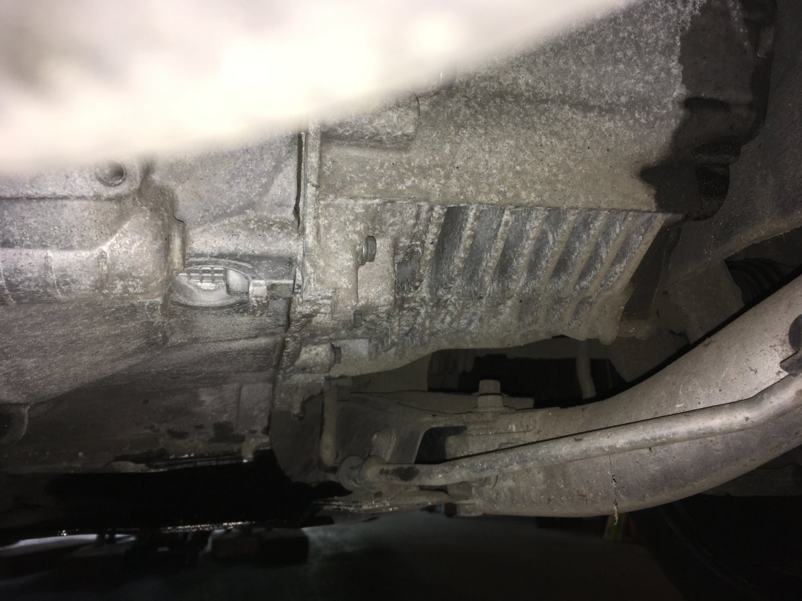

Just in the process of changing my gearbox oil, ML6C.
Confused on the ''does it have cooling fins'' for the correct amount to put in, Mine only has fins on the bottom as per the pic,
My plan was to measure what came out and make a educated guess from there, But ended up with some of it on my workshop floor, due to the drain location.
Any advice greatly received
Oil that came out was very dirty, and metal sludge on the magnet, I don't know how Citroen can say filled for life.....
Steve

Did you discover whether the small finnage was with fins or without fins?
