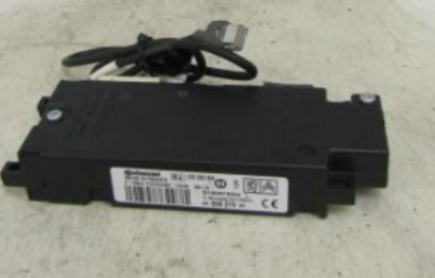

You have a separate module installed that is the hands free / Bluetooth unit. This is installed behind the dash and is responsible for the bluetooth elements and talks to the head unit and display screen.
It looks like this:
This unit was updated with a replacement part, so could of gone faulty on you. So if there is no joy with the BSI reset, nor with your new RD4 unit, I would suspect the bluetooth Nomad Unit.
It looks like this:
