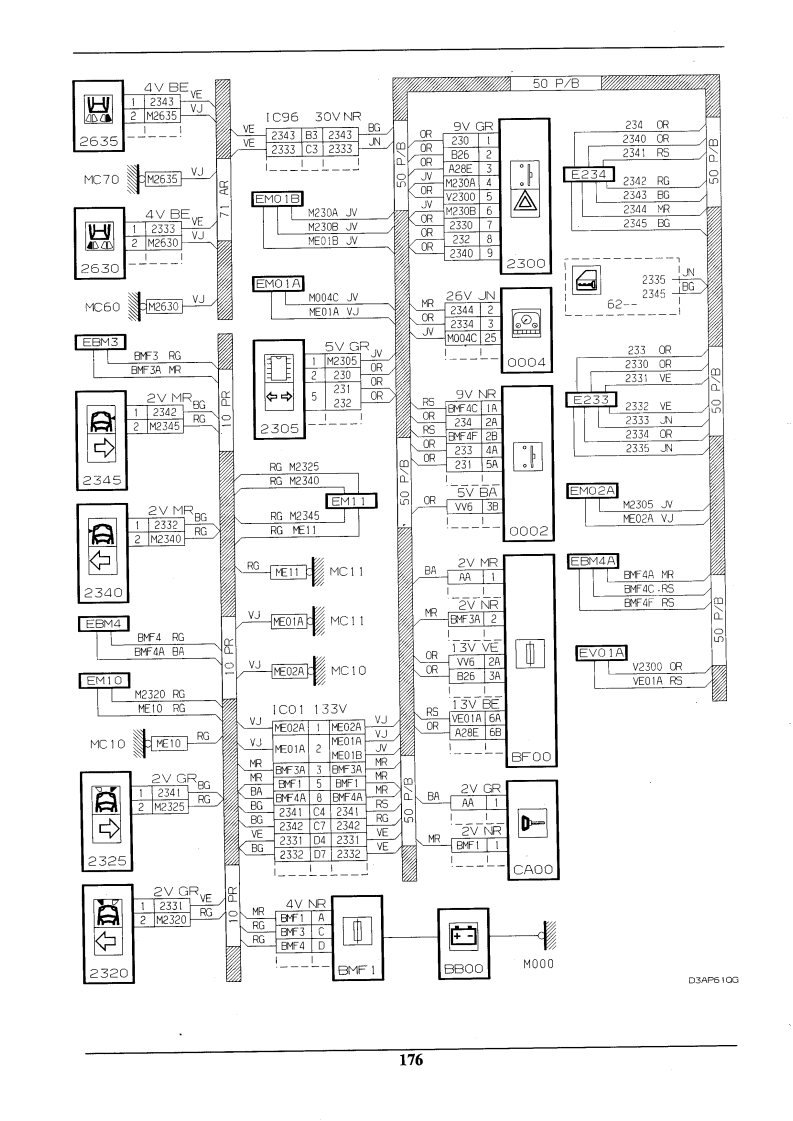

Same car as the Airbag problem. Neither the indicators or the hazards work. I've checked the fuses, both good (multimeter), checked feed to the fusebox. The hazard terminal has 12v, the indicator terminal has about 1v with the ignition on. I've read through a lot of old posts that mention the stalk being the problem, others mention the relay, and others mention the hazard warning button. I haven't got a BOLs for this car. How does the hazaed warning button come out. At least then I can check for 12v at the button and continuity through it.

Pop up your VIN, Pete, if you'd like the circuit diagram posted.

Thanks Chris, VF7**************[VIN obfuscated, can be read by forum staff] .

Also the indicators and hazards are fed by different fuses, and note that The indicator switch cannot stop the hazard lights from working, as it is bypassed by the hazards switch.
