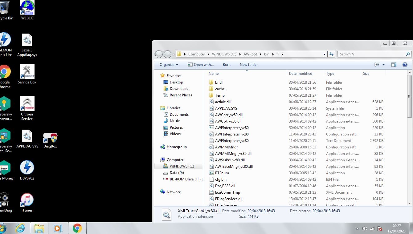

When you did your original installation, did you make a back-up copy of APPDIAG.SYS from C:\AWRoot\bin\fi?
If you did I suggest you copy it back over the original, probably damaged, file in C:\AWRoot\bin\fi.

Yep, APPDIAG.SYS has a back up copy on my desktop from C:\AWRoot\bin\fiPaul-R wrote: 12 Apr 2020, 18:00 When you did your original installation, did you make a back-up copy of APPDIAG.SYS from C:\AWRoot\bin\fi?
When you say copy it over, do you mean right click APPDIAG.SYS and copy then paste it on to C:\AWRoot\bin\fi?

Anytime you are asked for a password and login - usually on performing a certain function, if you decline it will deactivate.
Just Exit the application, restart the laptop then copy the backup you made of the file ^ above ^ (assuming you made a backup when you first installed it). If you didn't make a copy of this file, then I'm afraid it's a total uninstall, registry and file clean up and reinstall again. The licence file is unique to each installation so no good asking for one from elsewhere (just in case you were contemplating any alternatives).

Thanks Marc, I definately did back that file up at time of installation, so I have the following:-GiveMeABreak wrote: 12 Apr 2020, 20:13 Anytime you are asked for a password and login - usually on performing a certain function, if you decline it will deactivate.
The back up file is saved to my desktop so OK to send a copy of that to the folder AWRoot?

Right, so I deleted the original APPDIAG.SYS file from the folder above, then copied the desktop backup version and pasted it into the folder to replace the deleted one.
Assume this should now work?
Will have a go tomorrow and ensure that I am offline (internet).
In the meantime, if this isn't correct, please let me know.

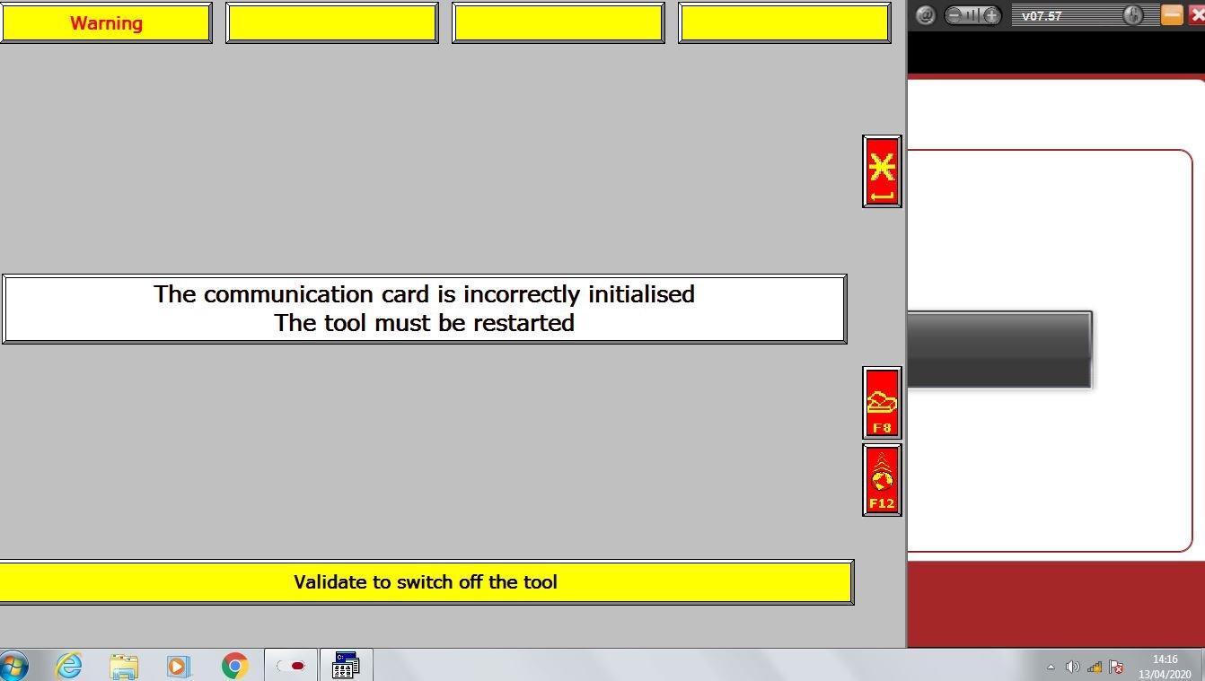

No go, getting to this when entering VIN before I can get to diagnostics on 'test by function'...GiveMeABreak wrote: 12 Apr 2020, 21:49 Yes, that should be it. Make sure your wireless network adapter card is switched ON, but make sure you disconnect from any of your WiFi Router's network connections. Disconnect and make sure that 'Automatically Connect' is switched off so id doesn't automatically log you onto your WiFi network again. The WiFi adaptor card itself needs to be on as the MAC code of the adaptor is used as part of the encrypted licence code.
Does this mean a complete reinstall?
Thanks
- x 6963
Re: Lexia 3 / Diagbox Citroen C4 1.6 HDI
That looks like a communication problem - it should be detecting the VIN automatically. If it's not, then it's not communicating. Check your interface - is the green light on the VCI lit all the time?
