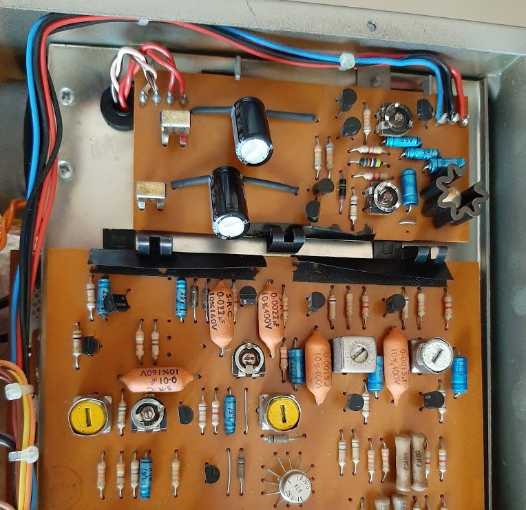

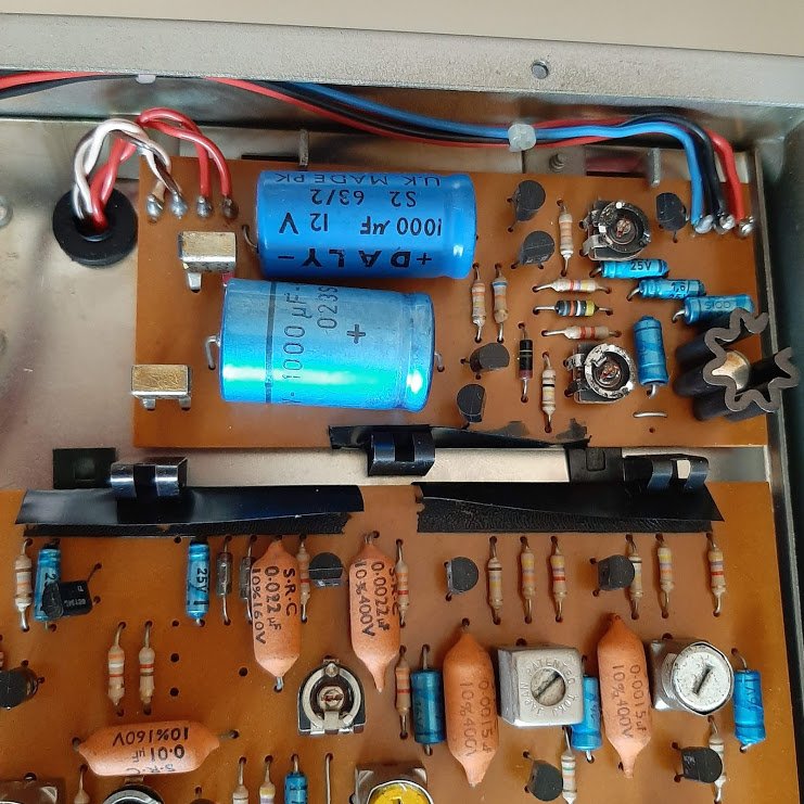

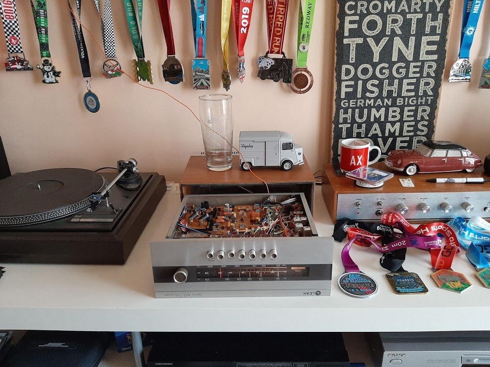

My Leak FM tuner has had an intermittent fault in the power supply for ages... It would switch on OK, run for a bit and then die. A gentle tap anywhere on the case would make it spring back to life...
Investigations led to the discovery that gently touching one of the big blue main smoothing electrolytics would 'fix' the problem for a while...
So today, I finally got round to replacing them...
The problem remained...
I think I have now finally found it... And it looks like a manufacturing fault from 45 years ago.
The series regulator transistor - the one with a crinkly heat-sink around it - was very poorly fitted with leads barely long enough to have decent soldered joints made to the circuit board. I desoldered it, removed it and found these very short leads were quite tarnished and not amenable to being soldered.
I cleaned up the leads, straightened them to make them as long s possible, refitted and touch-wood, all now seems good.
I'll leave it upside down and uncased for a few days to see if it really is now fixed!
One thing I did discover is just how bad my eyesight has got. Oddly, at my last eye test a few months ago all was good but I've noticed a deterioration since the accident even before I called on them to do some demanding electronics. A visit to the opticians will be on the list of things to do once the lockdown is lifted...
Also, doing delicate work with ongoing nerve damage (again, from the accident) in the fingers of my left hand is not easy either.
Thank goodness my right hand is OK!

Nice neat job Jim. Potted electronics are a pain to work on but nothing ever moves and breaks.
