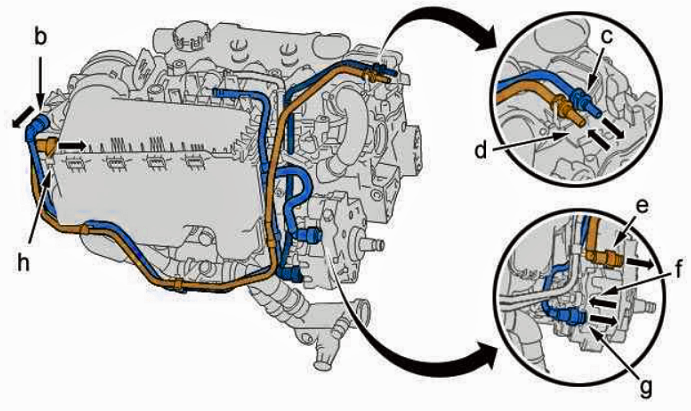

Here's a little more detail for you. This is the DV6TED4 110 (without Particle Filter).
Special features:
| Flow Chart - Fuel Supply Key:
| Reference | Designation |
| a | Diesel injector fuel return towards fuel tank |
| 1 to 4 | Diesel injectors (electrohydraulic) |
| 5 | Fuel cooler |
| 6 | Fuel tank |
| 7 | Sensor for presence of water in diesel fuel (according to model) |
| 8 | Fuel filter + water in fuel separator |
| 9 | high pressure fuel pump |
| 10 | Fuel temperature sensor |
| 11 | Fuel high pressure common injection rail |
| 12 | High pressure fuel sensor |
| 13 | Manual fuel primer pump |
| 14 | "T" adaptor union |
| 15 | 4-way union (3 inlets ; 1 outlet) |
| 16 | Discharge jet |
| 17 | Waste gate |
| 18 | Flow jet |
| 19 | Transfer pump |
| 20 | Fuel flow regulator |
- The discharge jet ( 16) permits a rapid discharge from the fuel high pressure common injection rail when there is a rapid "foot off".
- The flow jet (18) limits the supply of fuel to the transfer pump (19) at high engine speeds.
- Fuel supply circuit with negative pressure: Induction by transfer pump integral to the fuel high pressure pump.
- Fuel heater function incorporated in the fuel filter.
- Water in diesel fuel detector (7) (according to market).
| Reference | Designation | Special feature |
| b | Fuel outlet from diesel fuel filter towards T adaptor | - |
| c | Fuel outlet towards fuel tank | Green endpiece : Ø 8 mm |
| d | Fuel inlet towards the fuel filter | White endpiece : Ø 10 mm |
| e | Fuel inlet into the transfer pump | The transfer pump is incorporated in the fuel high pressure pump |
| f | Fuel outlet from the high pressure pump towards the fuel high pressure common rail | - |
| g | Fuel outlet from the high pressure pump towards the fuel tank | - |
| h | Fuel inlet into the fuel filter | - |

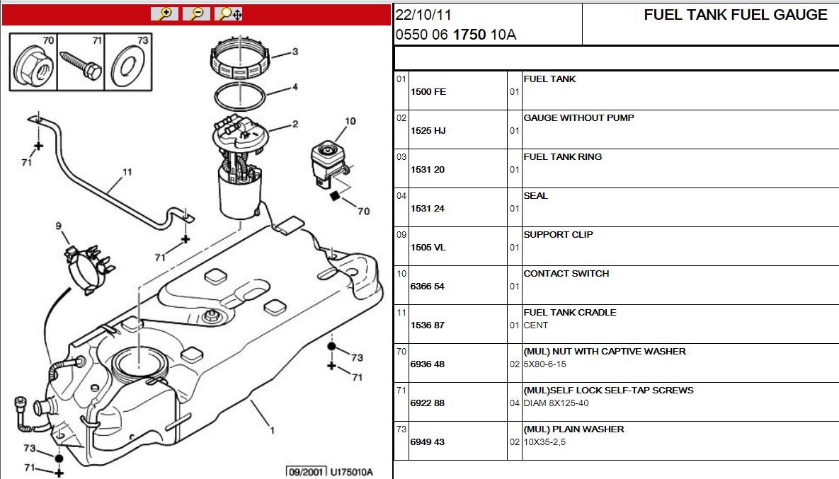

After the AA man's hitting the tank, just to add Marc's info on Level sender, but no pump...
Not sure about Picasso, but fuel interruptions at the tank not unknown.
- pick-up strainer/coarse filter (likely part of the pick-up/sensor) blocked
- plastic tank bottoms have been known to rise upwards, when tank not very full, and block off the pick-up
- crud/sludge/water in the bottom of the tank
- partial vacuum in the tank (breather not functioning)
A thud to the bottom of the tank could dislodge some of these, temporarily.
