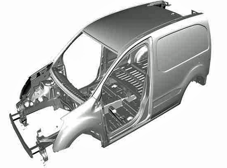

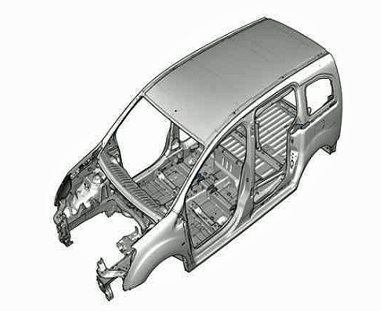

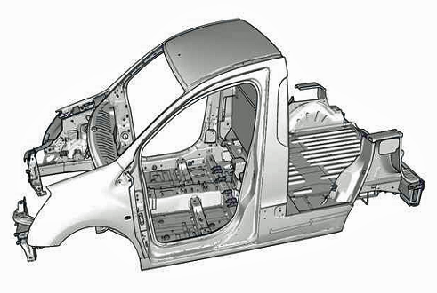

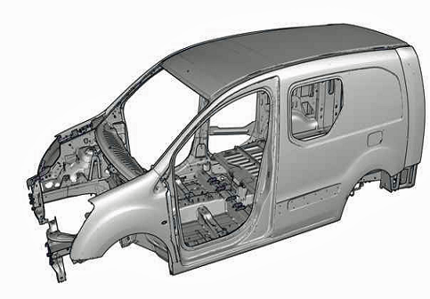

These are designations for the MK I, MK II and MK III:
Berlingo
Berlingo M59
Berlingo B9
Using the B9 (MK III) for this example - you can see the possible options:
So as you can see there is a family car, 2 versions of Utility Vehicle and a Cab version.
The Designation VP and VU is simply the French abbreviation for Private Vehicle and Utility Vehicle as in this case:
I'm not going to go into all the options as I'll be in my grave before I finish - suffice it to say there are combinations of options within these versions depending on what the customer wants.

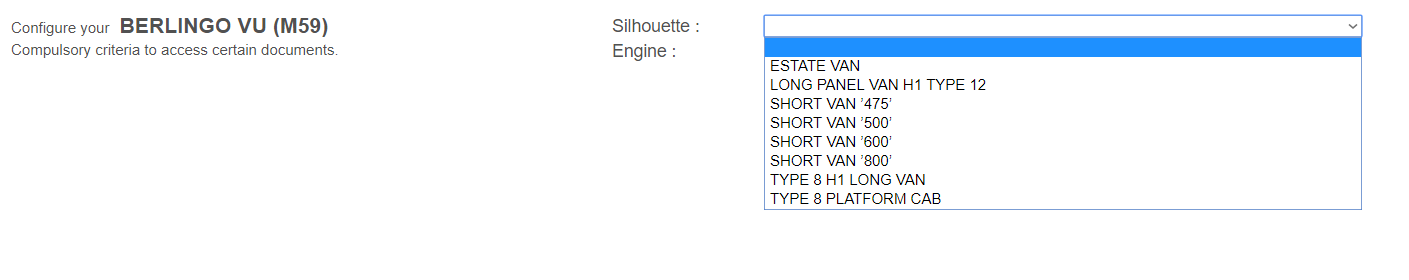

I actually am kind of aware of all that but the three silhouettes still stay unanswered. I see that they, those silhouettes apply throughout the whole range of models and I'd like to have it claryfied. I myself have used ServiceBox until it was for free and used SEDRE and DocBackup aswell, so it's no first glance at this kind of materials from me. I do work for a dealer (not PSA) myself and am aware of how one's programs and catalogs work. In this case the unexplained classification bugs me, I'd like to understand it.
By the way M59 VU has 7 silhouettes on its own, I still wonder what are those 3 VP silhouettes IRL.
