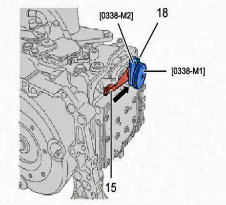

Did you carry out the procedure to adjust the Internal Selection Control? This is required after any work on this or the hydraulic block....

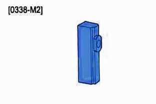

Recommended Tools
CAUTION: Check the operation of the gear selection control in all the positions. The lever must have no overtravel (17) when it is in the mechanical stop position towards the rear (In the direction of the arrow).
Recommended Tools
| Internal selection control adjustment screw | Internal selection control adjustment shim |
| Note: The adjusting is done with the cover (2) of the hydraulic block (4) removed. Caution: Move the lever (17) to the mechanical stop position towards the rear of the vehicle (In the direction of the arrow) Hold the lever (17) by means of a plastic locking clip during the adjusting procedure.

Thanks. Worked off an internet video so did not do this.... If I do not have the right tools, how to adjust?
- x 6958
Re: Citroen c5 x7 electric problems
These tools are what the dealer would use (and they're not really something the DIYer would necessarily have) - so you'll either need to improvise, try and locate something similar or take it to the dealer to get adjusted. These tools are part of a wider set of an AL4 gearbox toolkit that is about €1400.

Thanks! All these electrical gremlins are also related to the not correct position of that roller blade?
- x 6958
Any work on the hydraulic block may have a knock-on effect down the line and could affect the gear selection, so I would do that first before looking at electrical issues, otherwise you may be looking at unnecessary work.
As you are having intermittent issues with the selection, the gearbox may be going into a backup mode until the issue is resolved. I would at least get the adjustment done first, then you can deal with any remaining issues, as that will rule out something you know you didn't do.

Today I opened the hydraulic bloc again, changed the solenoids yet again, adjusted the internal selection control, checked if it would cycle through the gears as it is supposed to do and closed it up again. Started the car and cycled through the gears. Car would not stall in N anymore and gear selection was without fault. Have not had any faults since but only took it on a short drive. Will use it tomorrow to go into work. For now it does look like the gearbox ecu goes into a standard mode and stops communicating to all other parts which in turn throws all those errors..... Will report in a week's time again.

I'm facing the same problem - I have to replace the two solenoids and I see that the best way to do it is with using the two tools described by GiveMeABreak, which of course I dont have and by judging by the price of it, I would not even consider buying it. what I would like to ask is if somebody have a drawing/sketch of these parts - including measurements, of course, so that I will be able to manufacture them (let my humbly point out that I have the ability to do it.

I used the screw mentioned in above explanation and a washer that is bigger than the hole on the selector lever. Worked no problem and you probably have such a washer around already....
