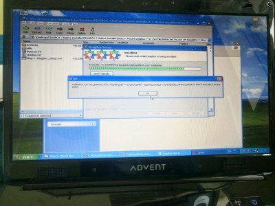

Hi all, My current laptop with diagbox is dying so I'm installing onto a newer laptop. Easydiagnostics kindly sent me latest software download yesterday but I keep hitting an error about 75% install.
Here are screenshots
I retro fitted windows xp to the laptop and only plan on using it to talk to the car.
Any ideas?
Gino
Any ideas?
Gino

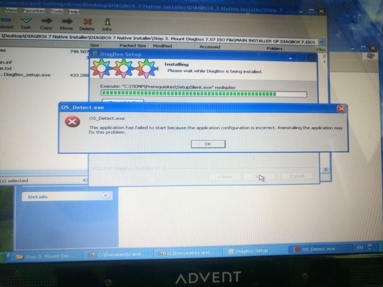

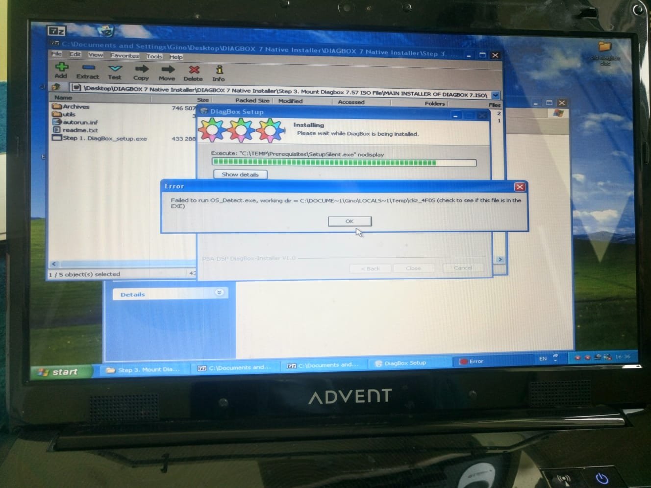

oops put the pictures in the wrong order. Second one was first and when I click "OK" the first picture message pops up.
I did try uninstall/reinstall but hit the same problem. It looks like a file is missing but I've no idea how to resolve this
Gino
Gino

From that screenshot, it doesn't look like you first mounted the ISO file.
You can't run it from the desktop directly. You need to mount the ISO file to a virtual drive on you laptop, then run it from the drive letter that it assigns Gino - and don't forget to run it as administrator.
