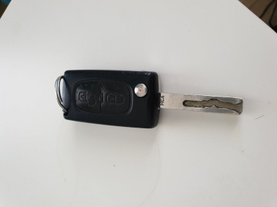

Hi,
Anyone can recommend a place where I can order a new case for my key? This spring for the key is not working so the key is always out.
And can I transfer it myself to the new case or do I need to visit Peugeot to do it?

You can buy replacement shell cases quite cheaply and transplant the parts over - but be aware that the key spring mechanisms are very fiddly.
So I recommend that you buy a shell with a blank key blade that you can get cut at a locksmith - as this is already fitted. Trying to dismantle the old spring and pin on these and refitting them is almost impossible without breaking it and then it is pretty much useless. The dealers will not replace these - they will only sell you a new one and code it for you.

jonas-swe wrote: 27 Mar 2020, 12:12 Hi,
I am not sure from your description whether your existing fob can be fixed by just re-tensioning the spring.
These fobs operate so that the spring pushes the blade into the open position when the button is pressed and the blade is pushed in manually to close it.
Are you saying that you cant push the blade to the closed position, or that it won't latch in that position?

I can push the blade back into the case, but the spring is too loose to hold the blade inside the case.

jonas-swe wrote: 27 Mar 2020, 20:53 I can push the blade back into the case, but the spring is too loose to hold the blade inside the case.
That is still confusing, the spring is supposed to push the blade out of the case, the blade is held in (against the spring) by a latch on the button.
Assuming that the case is not actually broken, the spring is tensioned:
  • remove the top cover of the key case,
  • pull the button out
  • with the key blade in the open position...
  • gently push the button and spring back in while twisting it, you should feel the end of the spring engage with the slot in the bottom of the case
  • When the end of the spring has engaged, twist the spring and button 90° - 180° anticlockwise until the button goes all the way into the case.
