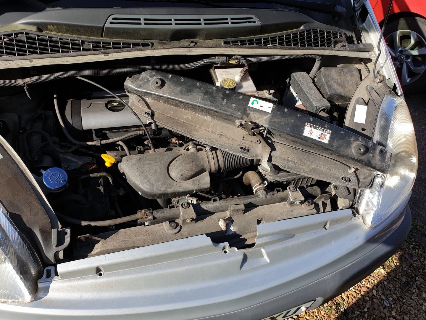

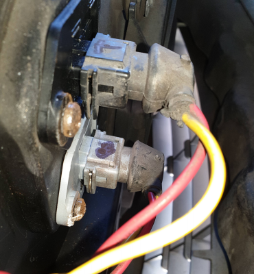

The engine cooling fan on my 2003 Zara Picasso 1.8sx does not work. I took it for an MOT and they abandoned it when it overheated during the emissions test. Under normal driving conditions it does not overheat. I tested the two fan resistors with my multimeter and both .54 Ohm and .8 Ohm were faulty so I replaced with new ones, but the fan will still not work. When I switch the aircon on, I hear the clutch noise and there is a drop in power so I assume it is trying to work, but again the fan does not kick in. I'm not sure how to test the three green relay boxes and I don't know which fuse controls the fan, so any advice appreciated.

Thanks for the replies. I know where the fuse boxes are, just not which one is for the fan as I cant find the information online.

If you disconnect both the big resistors & power up pin 3 with 12v this should put the fan motor on full speed to prove the fan is ok.
